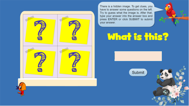

This slide includes three main parts, the instructions, puzzle question, and 4 pieces with a hidden picture. To create this slide, perform the following:
1.1. Insert a Question with Media slide. (Home tab > New Slide > Question with Media).
1.2. Insert other objects such as the picture, 4 pieces, animal images for decoration, and instructions. (Insert tab > Image). Then, customize the sizes and drag them to the suitable position.

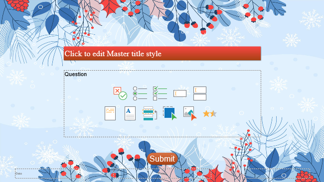

2.1. Open Slide Master. (View tab > Slide Master).
2.2. Select the Question Layout and customize it. For example, I add a background image (Properties pane > Slide Properties tab > Background Fill > Image Fill > select an image from the computer), edit the text size and color of the question.
2.3. Add slide transition. (Transitions tab)
2.4. Close Slide Master after having done creating the question slide layout.
2.5. In normal view, add the slide layout you have created in Slide Master to add new questions.
For more information, please visit Use Slide Masters.

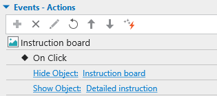

4.1. Interactivity for the instructions: show detailed instructions and voice commands when players click the instruction board.
When the game starts, there is an instruction board appearing at the top right corner of the screen. When the player clicks this board, the detailed instruction is showing up while the board is disappearing.
To create a voice for the instructions, we use text to speech function. (In the Properties pane > Audio > Generate text to speech).
We add actions for this part as follows:
- Hide the detailed instruction initially. (right-click the object > Initially Hidden).
- Instruction board: Add the 2 following actions:
For more information, please visit Work with Events-Actions.

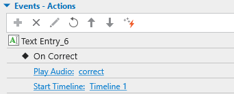

Add 2 actions to the answer section as follows:

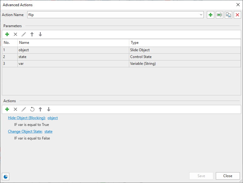

After that, we need to add variables and actions to each puzzle piece as follows:

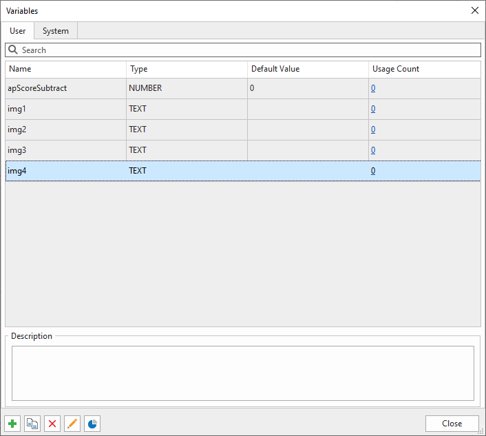

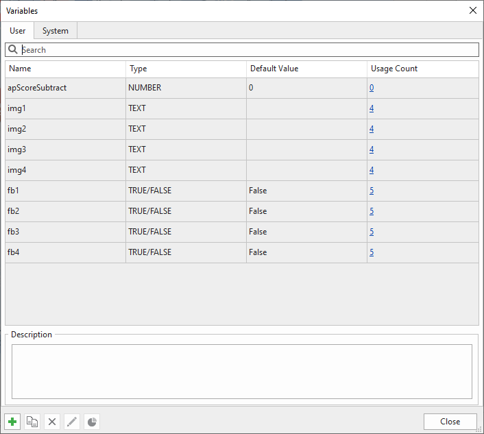

Add text variable. (Home tab > Variables > click the Add button to add). For more information, please visit Use Text Variables.

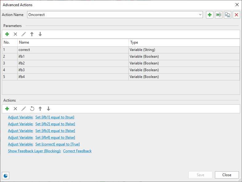

Add advanced action to Slide 1. For more information, please visit Work with Advanced Actions.
4.5. Interactivity for correct feedback layer
When players answer correctly, set the text variable to value True and show the image for illustration.
Since each correct answer shows a corresponding image for illustration, we use the True/False variable for each image. For example, set image 1 is equal to value True, the other images are equal to value False. If the answer is incorrect, then show image 1.
We create the True/False variables with the default values are False. For more information, please visit Use True/False variables.

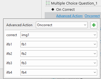

Then, we create advanced action for the On Correct event of each question as follows:

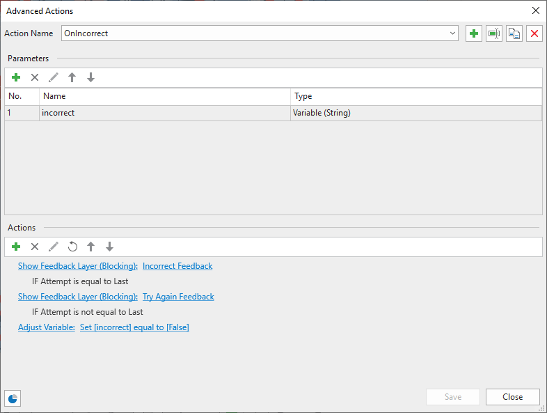

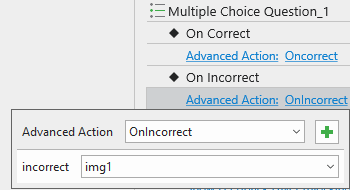

4.6. Interactivity for incorrect feedback
If players answer a question incorrectly, incorrect feedback will show up. So, we create the advanced action for this event like this:
After that, we add the On Correct action to the 4 question slides:
and the On Incorrect action like this:

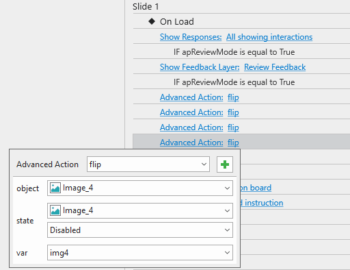

Finally, add the flip action to the OnLoad event of Slide 1:

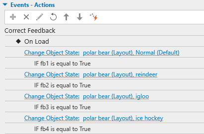

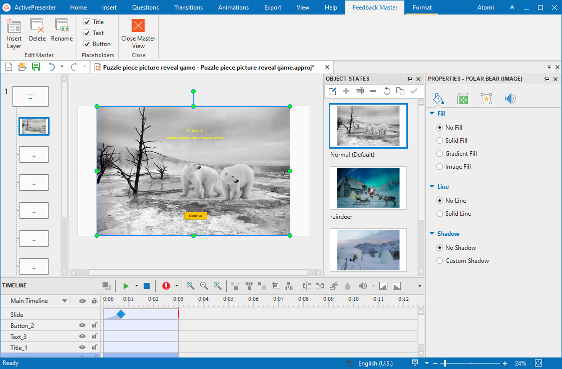

4.7. Customize images for correct feedback
Open the Feedback Master and add the following actions to the On Load event of the Correct Feedback Layer.
