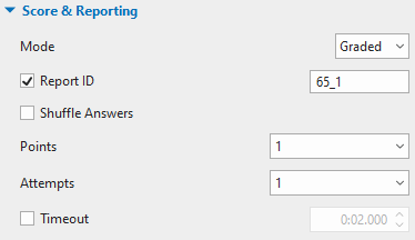

By default, learners can interact with questions one time. They get 1 point for each correct answer. However, feel free to customize these values:
  • Select the question area.
  • Navigate to the Interactivity tab of the Properties pane > Score & Reporting section > adjust the Points and Attempts values.
Score & Reporting.

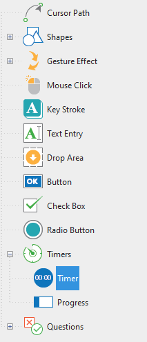

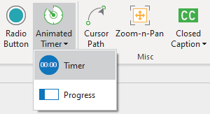

Now, turn to the next step to create tests with countdown timers. Follow either of the ways below to add a countdown timer:
  • Open the Insert tab > Animated Timer > Timer
Create tests with countdown timers, Add a Timer.
  • Open the Home tab > Interactions > Animated Timer > Timer.

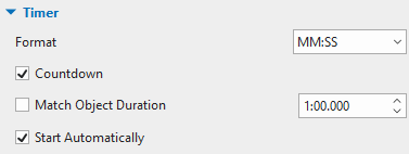

After inserting a countdown timer, you can edit its size, color, etc. as usual objects. To edit its distributes, select it, navigate to the Interactivity tab of the Properties pane > Timer section:
Create tests with countdown timers.
  • Format: By default, a timer appears with MM:SS time format. You can select another one in the drop-down list.
  • Countdown: This option is selected by default to make it count down. If you deselect this checkbox, it will count up.
  • Match Object Duration: Deselect this option and enter the amount of time of a question or test. For example, set 1 minute for a question. In case you leave this option selected by default, you can adjust the timer’s duration on the Timeline pane to define the amount of time.
  • Start Automatically: This option is selected by default to make an animated timer start as soon as a timer object starts showing in the main timeline.

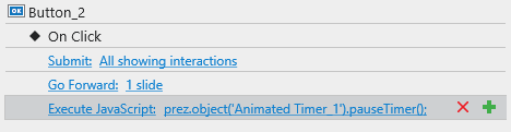

If learners submit all answers before time out, the timer will stop counting. Do as follow to make it work that way:
  • Select the Submit button in the last question slide.
  • Navigate to the Interactivity tab of the Properties pane > Events – Actions section > add Execute JavaScript action to the On Click event > add this code: prez.object('Animated Timer_1').pauseTimer();
Note that Animated Timer_1 in the code is the timer’s name in the project. Remember to customize it.
