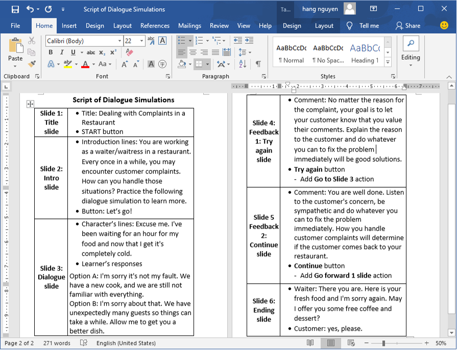

Write Scripts
Now you will write your full scripts based on the mind map you have created. Starting from the title and introduction slide, continue to develop the conversation, give feedback, and then finish it. Think of the branching, the learners’ responses, whether their answer can lead to another branch or return to the right path. With this in mind, you can write a logical and close dialogue simulation script.
Script of dialogue simulations

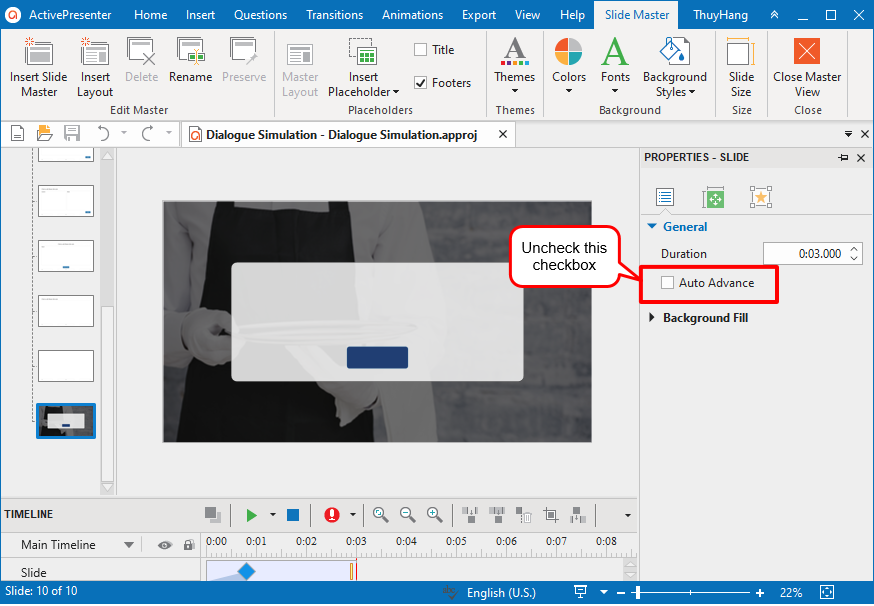

In my example, I will use 2 types of slide layouts, which are blank and feedback. These two layouts need interaction to move to the next one, so we have to uncheck the Auto Advance option.
Using Slide Master
Then, I will use the feedback layout to display different feedback messages. This means all the feedback in the project has the same style but carries different messages. Therefore, adding placeholders would be helpful to create a text box and button in Slide Master. After that, we can easily type text into them in the normal view. (View tab > Slide Master > Insert Placeholder > choose Text or Button to add).

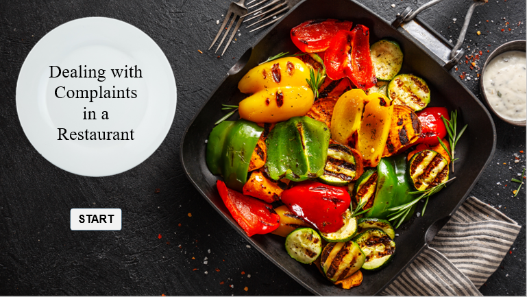

Title Slide
As you may know, the title slide is always a need for every project. It lets us know the course topic and often includes a button to start the course. According to the autoplay’s policies of most web browsers nowadays, muted autoplay is always allowed. And autoplay with sound is allowed if the user has interacted with the domain (click, tap, etc.). Therefore, inserting a button on the first slide is a great choice to handle this issue.
Dialogue simulation

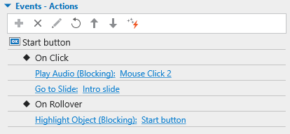

So, you can make this button interactive by adding a Go Forward action to it. Or even make it more appealing by adding a hover effect and click sound. For example, when your learners hover the mouse over the START button, it will be highlighted.
Start button

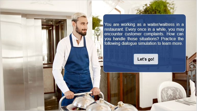

Introduction Slide
The introduction slide is not so different from the Title slide. It also includes content and a button for learners to advance to the next slide. However, since the purpose of this slide is to introduce the course, it contains brief information about what learners are supposed to do next. You can insert and style shape with introduction lines. Then, add a Go Forward action to the Let’s go! button as in the previous slide.
Dialogue simulation

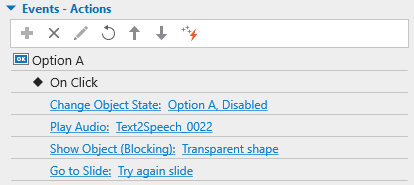

  • Insert 2 buttons at the timestamp where the character’s lines end. (Insert tab > Button).
  • Type the text into each button by double-clicking the button.
  • Create new audio for these 2 buttons. (Insert tab > Audio > Create New > Copy text from the shape you want to convert it to audio > generate the audio).
  • Add a transparent shape to cover the 2 options. This shape will prevent learners from interacting with the other option if one is selected. (Insert tab > Shape > Rectangle. Then make this rectangle transparent by changing its opacity to 0).
  • Delete the two audio objects that you have created.

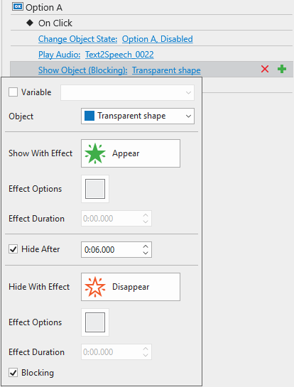

  • Add actions to these two buttons as in the image below:
Option A
Please refer to this tutorial on how to add events -actions in ActivePresenter.
Note that you have deleted the two newly created audio objects, so now you have to add them again to the options by clicking the Select an audio from project button. Also, we should uncheck the Blocking option for the Play Audio action. By doing this, the next “showing the transparent shape” action will be executed simultaneously. For the transparent shape, Hide After 6 seconds, which is equivalent to the duration of the audio, and check the Blocking option.
Show transparent shape

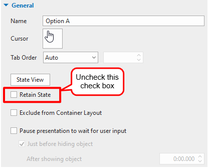

Finally, we uncheck the Retain State checkbox so that the button will reset its normal state on the slide revisit.
Retain state

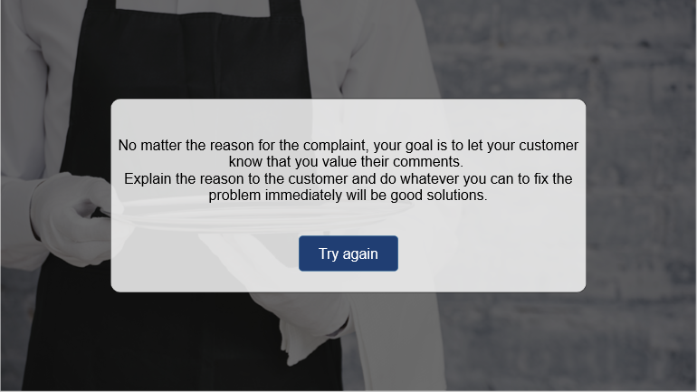

Feedback Messages for Dialogue Simulation
Feedback

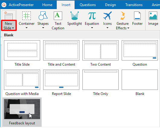

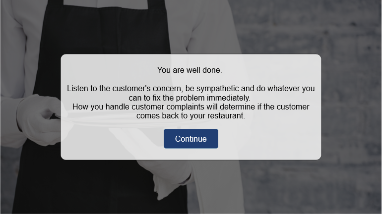

In a dialogue simulation, feedback messages are indispensable. As aforementioned, each option that learners choose will lead to a different consequence or feedback. One takes learners to the previous slide, the other takes them to the next slide. Since feedback layouts have been created in Slide Master, now we can easily add a feedback layout slide to the project as follows: In the Home or Insert tab, click the arrow on the New Slide button, then choose the desired one.
Insert feedback layout slide

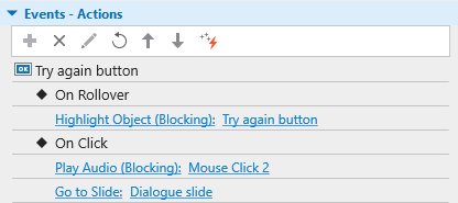

Then, add text into the text box and the button. Finally, we add actions for this button:
Add actions to Try again button
Similarly, I will create a congratulation feedback slide for learners to continue the simulation.
Continue button

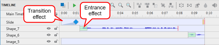

Basically, you have done creating a simple dialogue simulation. However, to make the eLearning course more appealing, you can add transition effects to slides or entrance effects to the character’s lines.
Add more effects
