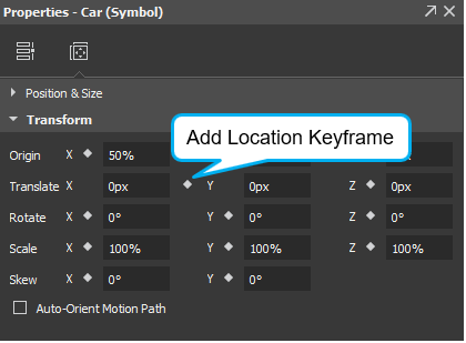

Step 3: In the Properties pane > Position & Size tab > Transform section, click Add Location Keyframe icon to insert the first location keyframe.

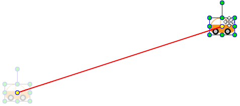

Step 5: On the Canvas, drag the element to a new position. This creates a red line indicating the path of the motion. The Location property value changes, thus animating the element along a motion path.

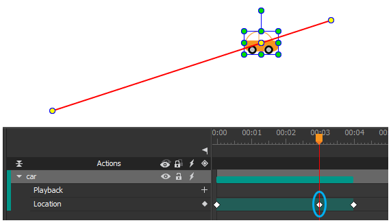

To create a key anchor point, add a Location keyframe at a desired point of time. In the figure below, a Location keyframe is added at the third second, creating an associated key anchor point on the motion path. Location keyframes represent two separate motion paths. So, you can add a Location keyframe to split a path into two. Or, delete a Location keyframe between two paths to create a contiguous path.

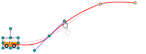

To create a normal anchor point, hover over a motion path until the mouse pointer turns into a pointing hand. Then, click and drag the path as desired.

With any anchor point selected, its control points appear to help adjust the path between two anchor points. Drag the control points to modify the path.
Note: When dragging a single control point, the remaining one will move to keep the angle between them unchanged. To change the selected control point only, hold down ALT and drag the point.

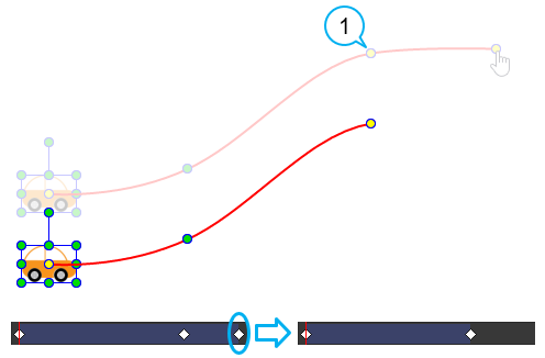

(1) The key anchor point is the first/last point of the path AND there is no anchor point between this point and the next/previous key anchor point: The associated Location keyframe will be deleted.
In the figure below, there is no anchor point between the last and the previous key anchor point (1). Therefore, deleting the last key anchor point is equal to deleting the last keyframe.

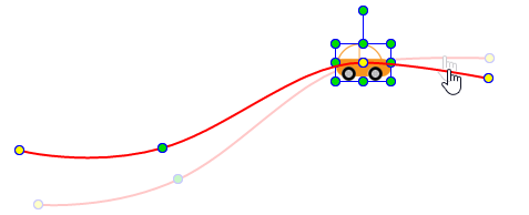

It’s possible to rotate a motion path. Hold down ALT, then click and drag the path. The path will be rotated around the element’s transformation-origin point.
Moving Motion Paths
You can move the path without changing the relative movement of an element. Hold down CTRL, then click and drag the path to move it.
Note: As stated earlier, when the Playhead isn’t on a Location keyframe, dragging an element is equal to moving the entire path. The path’s shape stays unchanged.

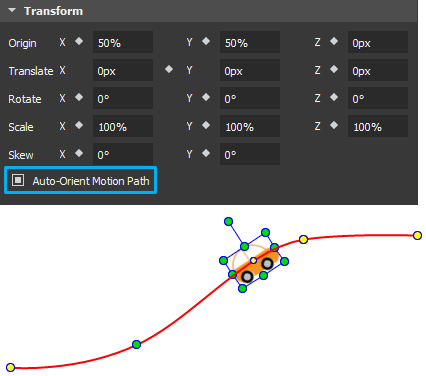

Orienting Elements to Paths
Imagine you want to animate a car to drive up a slope. As the slope is not a straight line, you need to use a motion path to move the car. However, even with a motion path, the car’s movement is still unnatural because the nose of the car doesn’t orient along the direction which it is heading.
To solve this problem, use the Auto-Orient property to orient elements in relation to the direction of the motion path. The Auto-Orient Motion Path check box is enabled only if the element already has a motion path.
Note: If the right edge is not the “front” of an image, you may need to rotate the element so that the correct edge is on the right side. For example, if the car is moving to the left direction with Auto-Orient on, it will flip vertically. In that case, rotate the image by 180 degrees to avoid flipping.
