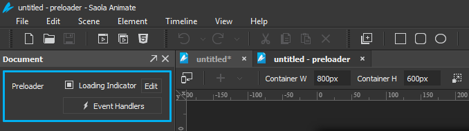

Step 1: Open the Document pane. If you don’t see this pane, on the main menu, click View > Document.
Step 2: Click Edit to customize the default preloader in the Preloader window.
The loading indicator has six editable properties. To adjust their values, you can drag the handle on the slider, scroll the mouse wheel, or enter a new value.

You can create a custom loading screen. In the Document pane, select Custom preloader and click Edit.
This opens a preloader document where you can create a loading screen of your own. You can insert elements and create animations as normal.
Take note of the following:
- The loading indicator appears by default, but you can clear the Loading Indicator check box to turn it off. Of course, you can click Edit to modify it as normal.
- A custom preloader document will close if you close the main document or if you switch from custom to default preloader.
