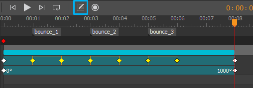

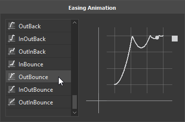

To customize easing, in the Timeline pane, select one or more animation segments, then click the Easing button or right-click the segments > Easing…. In the Easing Animation dialog that appears, select the easing you want.
Note: You apply a timing function to control the speed of the transition. Therefore, if a segment contains no transition, the timing function will be disabled. To remove or create transition, right-click a segment and select the corresponding options.
By default, transition allows an element to gradually change from one state to another over time. Without transition, the property will jump to the ending value at the ending keyframe. In other words, the property stays unchanged until the ending keyframe is encountered, making an instant change in the property value.

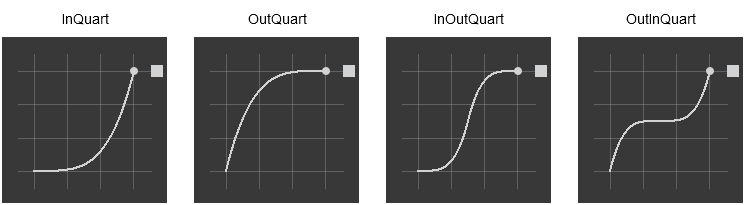

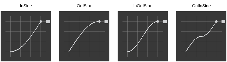

- Ease in-out starts slowly, reaches fastest in the middle, then finishes slowly. In other words, the transition speeds up until halfway, and then slows down.
- Ease out-in starts and ends fast, but becomes slow in the middle. In other words, the transition slows down until halfway, and then speeds up.
1. Quad: Display a quadratic transition.

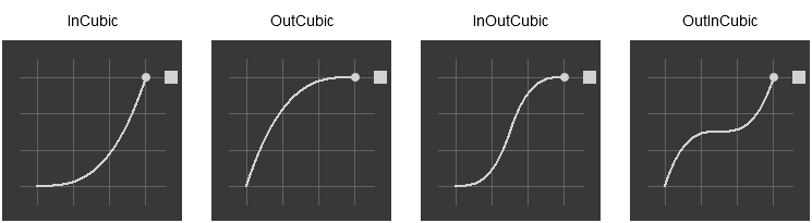

2. Cubic: Display a cubicular transition.
3. Quart: Display a quartetic transition.

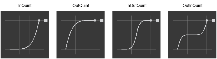

4. Quint: Display a quintic transition.
5. Sine: Display a sinusoidal transition.

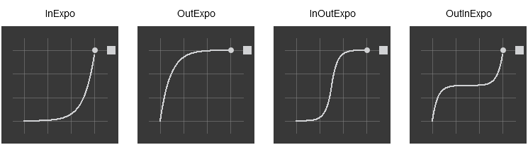

6. Expo: Display an exponential transition.

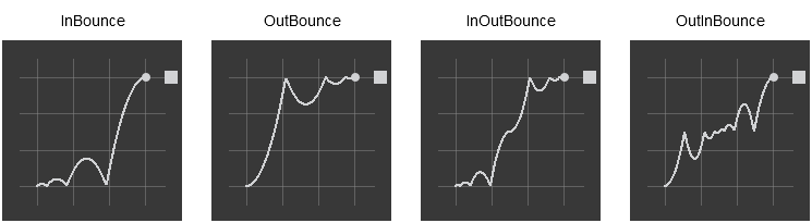

10. Bounce: Display a parabolic bounce, simulating the motion of an object bouncing.
