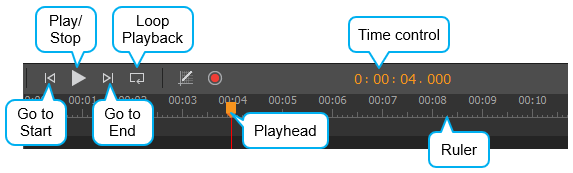

Saola Animate offers many controls to navigate the timeline by moving the Playhead. Do one or more of the following:
- Drag the Playhead to the desired location.
- Click the timeline ruler at the time where you want to move the Playhead. That way, the Playhead will immediately jump to that location.
- Change the time value in the time control (also the current time indicator). Just click on the time control to make it editable, then scroll the mouse wheel or enter a new value.
- Use shortcuts or the Playback buttons. Press SPACE BAR or click Play/Stop or to start or stop animation in real time. Press HOME or click Go to Start to jump to the start of the timeline. And press END or click Go to End to jump to the end of the animation. Also, click Loop Playback to play the animation in a loop.

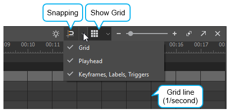

Snapping in Timeline
Dragging the Playhead along the timeline, you may notice some snapping actions. For example, the Playhead jumps to keyframes, triggers, or particular tick marks on the timeline ruler.
Timeline snapping lets you move the Playhead and timeline items such as keyframes, labels, and triggers as you wish. It helps out not only when you add keyframes or timeline triggers but also when you edit and fine-tune HTML5 animation. Timeline snapping lets you easily line up keyframes and animation segments on the timeline.
Timeline snapping is turned on by default with three modes:
- Snap to Grid: The Playhead and timeline items snap to the grid lines. Grid lines give precise measurements of the timeline by displaying subtle vertical lines at regular intervals. They only appear when you click the Show Grid button.
- Snap to Playhead: Timeline items snap to the Playhead.
- Snap to Keyframes, Labels, Triggers: The Playhead and timeline items snap to the position of timeline items.
Note: When you enable timeline snapping without any modes, the Playhead and timeline items will only snap to special tick marks on the timeline ruler. These tick marks appear depending on the zoom level of the timeline.

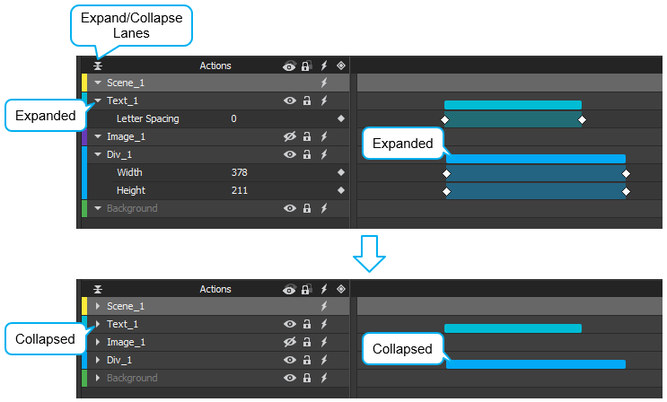

Showing and Hiding Element Properties
Click the triangle button to show or hide all animated properties of an element. If you want to expand or collapse all elements at once, click the Expand/Collapse Lanes button on the Actions bar.

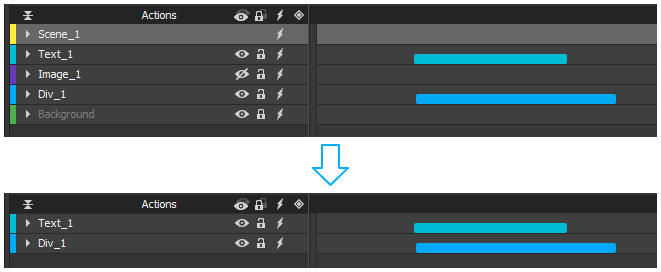

Filtering Elements
A scene may have a background image that stays unchanged over time. Obviously, you don’t need to clutter up the timeline with those static elements. So, you can filter out elements that contain no animation at all using the Show Animated Elements Only
button.
This filter only affects what you see on the timeline, it doesn’t influence what appears on the Canvas.

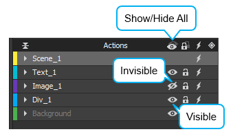

In the Timeline pane or the Elements pane, notice the Show/Hide button next to the element names. An open eye means that an element is visible, whereas an eye with a slash indicates that it is invisible.
To show/hide all elements in a scene at once, click the Show/Hide All button on the Actions bar.

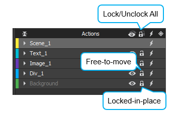

Locking and Unlocking Elements
Moving an element by mistake is a bad experience. For example, you want to move a text element but accidentally seize and drag a background photo. To avoid that, you can lock elements in their location. That way, elements cannot be selected, moved, or edited, but they still remain visible with the Visibility state on.
To lock an element, click the Lock/Unlock button next to the Show/Hide button. By default, elements are in the “unlock” state which is indicated by an open lock. At that time, you’re free to select them and make an edit. When you lock elements in place, the button turns into a closed clock and the element names get dim.
To lock/unlock all elements in a scene at once, click the Lock/Unlock All button on the Actions bar.
