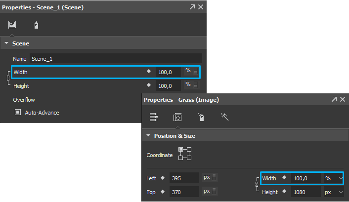

Let’s take another example. You want to a top level image to stretch the full width of the page while the page fills the width of the browser window. For that to happen, first you set the scene width to 100%, making the scene take up the entire viewport width. Then, you set the width of the image to 100% to make it stretch the full width of the scene.
