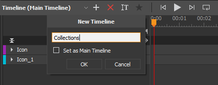

Step 1: Notice the top left of the Timeline pane. Click New Timeline (1).
Step 2: In the dialog, enter a unique name for the new timeline.
Step 3: Select Set as Main Timeline if you want the new timeline to act as the main timeline of a scene. In other words, select this check box if you want animations in this timeline run once the scene loads.

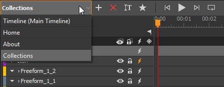

Step 4: Click OK to finish. The new timeline will be directly selected for editing. You can click the Timeline Selector (5) to switch between different timelines of a scene.

You can rename a timeline as you want. Select a timeline from the Timeline Selector and click Rename Timeline (3) to rename it.
