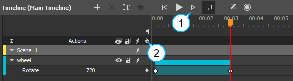

Step 1: In the Timeline pane, move the Playhead to the end of the animation. You can also press the END key or click the Go to End button (1).
Step 2: Press ALT+T or click the Insert Trigger button (2) on the Actions bar. This opens the Timeline Triggers dialog where you can define a trigger.

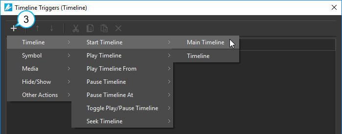

Step 3: Click Add Action (3) > Timeline > Start Timeline. In this case, the target object is the main timeline.
This attaches the Start Timeline action to the trigger (4) which makes the timeline play and loop as soon as it ends.
To see your loop in action, you can preview it in browser or use the Loop Playback button (5) in the Timeline pane. Be aware that the Loop Playback option loops only in the editor, not when the document is exported.

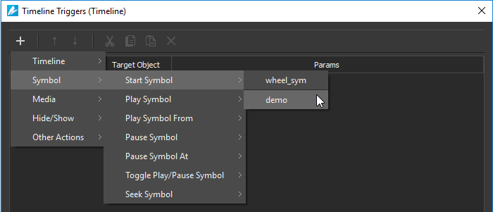

Step 3: Click Add Action > Symbol > Start Symbol. The target object can be the main document or any symbol you want.
- Similar to looping a timeline, you can use the Complete timeline event to loop the whole document. Just add event actions (Complete – Start Symbol) to the main timeline of the last scene in the document.
