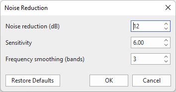

After that, the Noise Reduction dialog will appear like the image below. In this dialog, you can customize the values if needed.
reduce noise
  • Noise reduction: Control the amount of volume reduction. Keep this value as low as possible. A higher value can make the noise quieter but distort the audio track.
  • Sensitivity: Decide how much of the audio is considered as noise. Similarly, a higher value can remove more noise. But don’t abuse it. It can damage the audio.
  • Frequence smoothing (bands): Spread the noise reduction into adjacent bands. However, notice that smoothing can make the audio less clear.
Step 3: Click OK to apply the effect.
  • Noise reduction is a trial-and-error process. If it does not satisfy you, click the Restore Defaults and try again. Adjust the value a little bit each time to find the best suit.
  • Applying the noise reduction effect too many times can ruin your audio quality. Also, make your voice sound tiny and robotic.

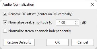

Step 2: Click the Audio Normalization button on the Timeline pane.
After that, the Audio Normalization dialog appears and allows you to customize some properties to make your voice sound better.
normalize audio
  • Remove DC offset (center on 0.0 vertically): The DC offset can distort the audio, so make sure that the waveform is on the 0.0 line. Select this option to remove the DC offset.
  • Normalize peak amplitude to a specific value: This helps bring the highest peak to the norm. -1.00 dB is considered an optimal value. Exceeding this value can make the audio distorted and hard to listen to.
  • Normalize stereo channels independently: If you have two audio tracks with different volume and want to mix them properly with a uniform volume, select this option. It helps normalize the channels independently, and adjust the amplitude separately for each channel.
