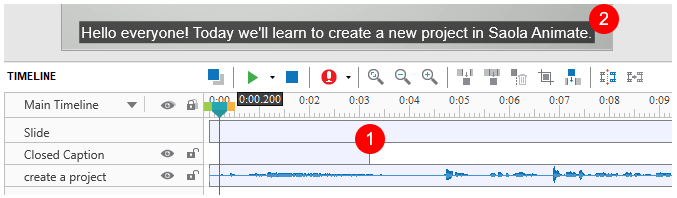

Step 1: In the timeline, choose the timestamp that you want to add a closed caption. Zoom in the timeline to get a better view if needed.
Step 2: Click the Annotations tab > Closed Caption. Alternatively, in the Timeline pane, click Closed Caption.
Both ways insert one closed caption line (1) at the position of the Playhead. On the Canvas, a closed caption editor (2) appears, allowing you to type the closed caption.
Step 3: Type the caption in the editor. Then, position the Playhead to another timestamp and repeat the cycle. All CC lines in a slide are put in the same line and considered as one CC object.
Step 4: Drag the CC line or either of its ends to change its timing and duration. You should display each CC line for adequate time so that your audience can read it comfortably.

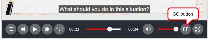

Toggling the Closed Caption Button in the Player
You can give users control over seeing the closed caption or not by enabling the CC button in the player. Using this button, users can toggle closed captions as they wish.
To enable the CC button, first open the Player Settings window by clicking the Export tab > Player Settings. Then, in the General tab > General Parameters > Toolbar, select the CC Button check box. Don’t forget to click OK to save changes.
