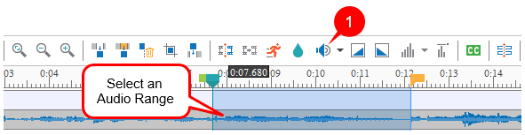

Step 1: Select the audio track in the Timeline pane, Selection pane or Canvas.
Step 2: Define the audio range in the Timeline pane. Just drag the green and yellow marker along the Timeline ruler to select the range.
Step 3: Click the Adjust Volume button (1).
This opens the dialog where you can scale the volume from 0 to 500. Check the Mute check box to silence the track.
Note: This is a relative volume scale with a default value of 100% (means original volume). It lets you adjust the volume from 0 (means mute) to 500% (means original volume x 5).

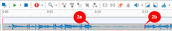

ActivePresenter will mark the audio part that has been adjusted volume with the red vertical makers (2a, 2b). These markers allow you to see the changes easily.
Drag the green and yellow marker of the Playhead to start red vertical marker and end vertical marker respectively.
Using the Snap mode, when you are dragging the green or yellow marker of the Playhead and the marker comes in the vicinity of the red vertical line (2a, 2b) of the audio range, it will make a tiny jump to match the edge of each other.

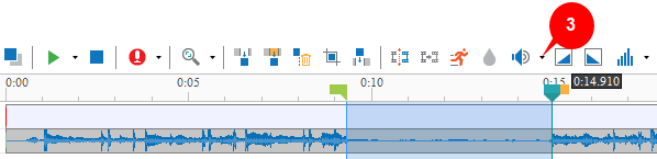

Step 3: Click the drop-down arrow on the Adjust Volume button (3) and then click Restore Original Volume.
After that, the Adjust Volume effect in that range will be removed and ActivePresenter will restore the original volume.
