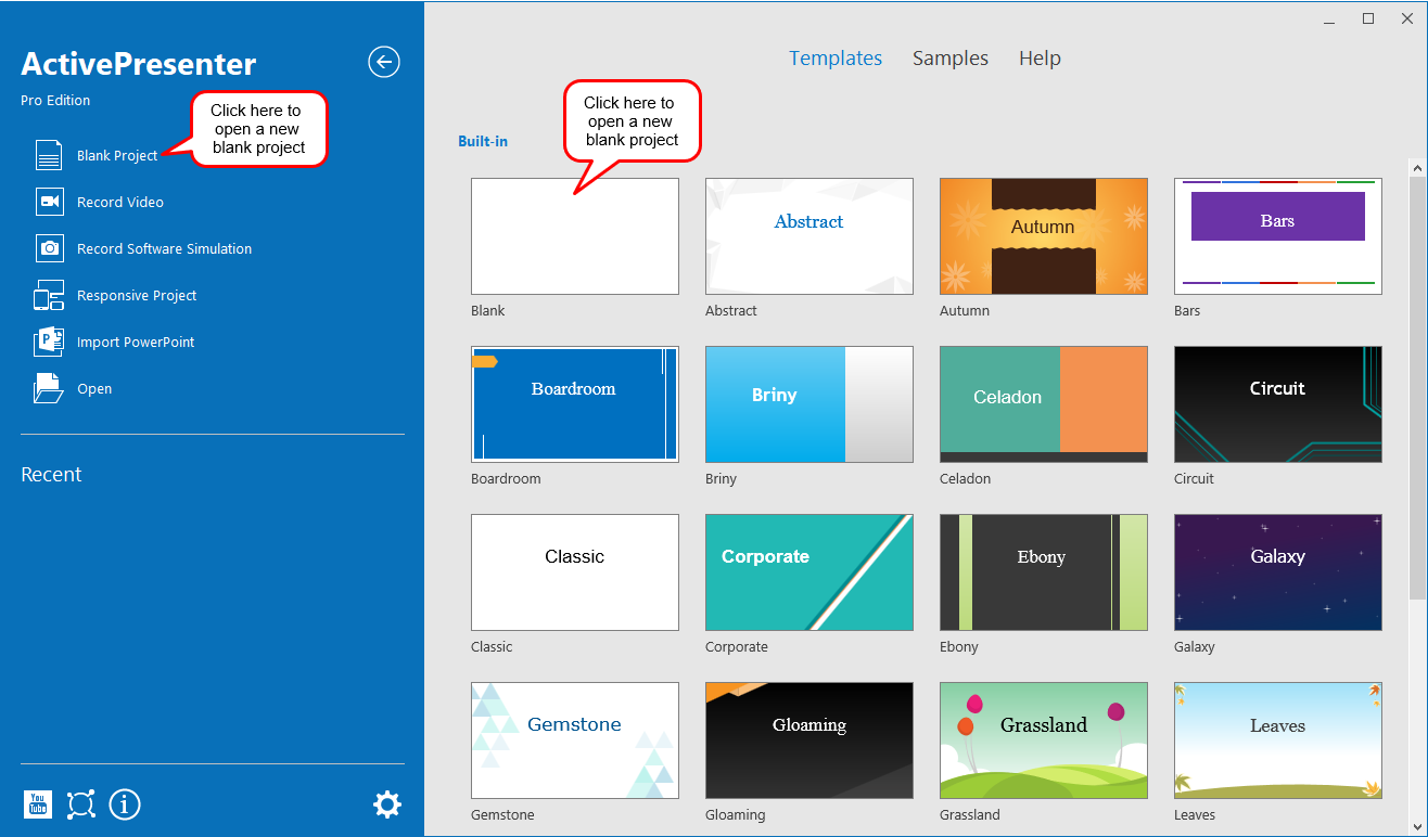

When you first launch the app, you will be presented with the Start Page. To start your first project, you can either click Blank Project in the left pane or click Blank in the built-in templates.

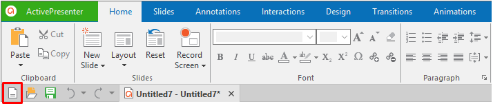

Alternatively, in the currently opening project:
Click the Create blank project button on the Quick Access Toolbar:

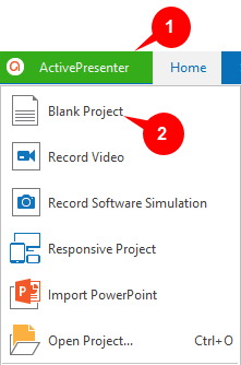

Step 1: Click the ActivePresenter button (1).
Step 2: Click Blank Project (2).
ActivePresenter will launch a new project with a blank slide.

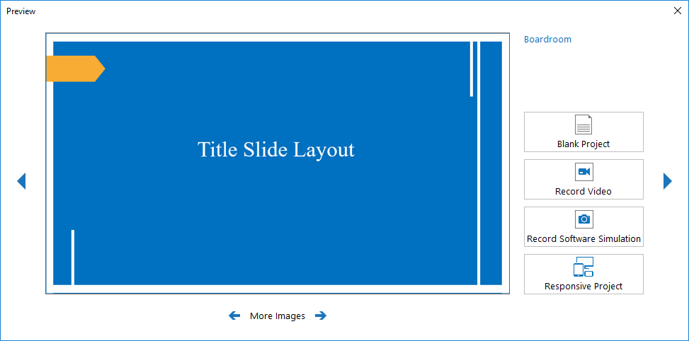

Creating Blank Slides from other Themes
ActivePresenter 7 provides many themes that save you a lot of time in creating contents and ensure the consistency of the workflow.
If you want to create a new blank project with any theme, in the Template tab of the Start Page, do one of the following:
- Click any of the themes and select Blank Project from the pop-up dialog.
- Right-click any of the themes and select Blank Projects from the context menu.

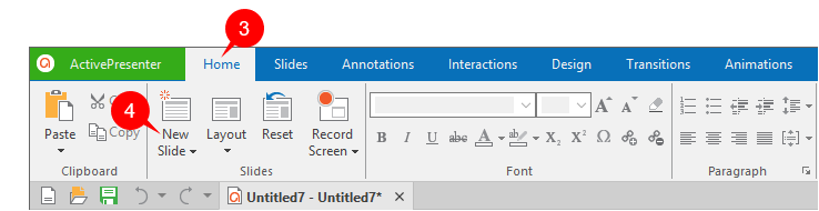

Step 1: Open the Home tab (3) or Slide tab.
Step 2: Click New Slide (4).

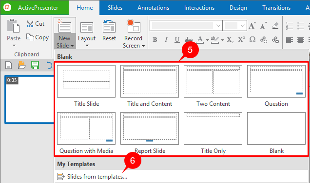

If you want to insert a new slide with a different layout, do the following:
Step 1: Click the drop-down arrow of the New Slide button (4).
Step 2: Select the layout from the drop-down list (5).
Step 2: Click Slides from templates… (6).
Refer to Inserting Slides from Templates for more details.

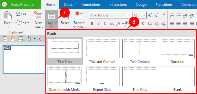

To change the slide layout, take the following steps:
Step 1: Select the slides that you want to change the layout. Hold CTRL while clicking to select multiple slides.
Step 2: Open the Home tab or Slide tab.
Step 3: Click the Layout button (7).
Step 4: Select the layout that you want to have (8).

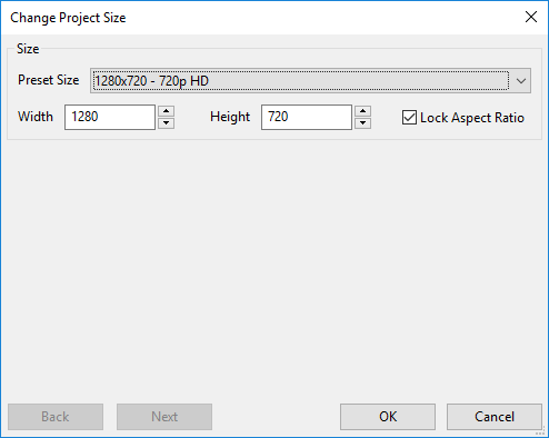

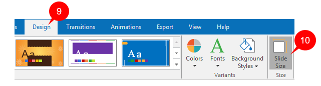

Changing Slide Size
After creating a blank project with a default size, you can change the size if needed.
Step 1: Open the Design tab (9).
Step 2: Click Slide Size (10).
After that, the Change Project Size dialog will pop up, do one of the following:
- Select one of the preset sizes from the Preset Size list.
- Enter values in the Width and Height spin box.
- Check the Lock Aspect Ratio check box if you want to keep the ratio between the width and the height of the slide size.
