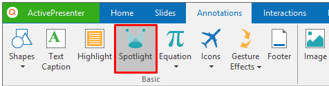

Step 1: Click the Annotations tab > Spotlight.

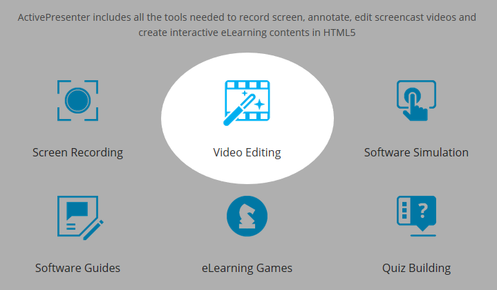

A spotlight object is immediately inserted in a slide. It retains the original brightness within the spotlight shape while darkening the rest of the screen.
Step 2: Resize and reposition the spotlight object as you wish. You can drag the resizing handles (green dots) to change the size and drag the object to a new position.

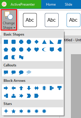

Step 3: Optionally, change the spotlight shape by clicking the Format tab > Change Shape > choose a new shape.

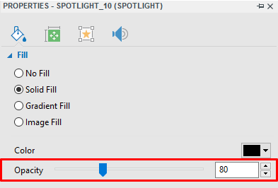

Step 4: Optionally, adjust the transparency level of the area surrounding the spotlight shape. Just select the spotlight object, click the Properties pane > Style & Effects > Fill > Opacity.

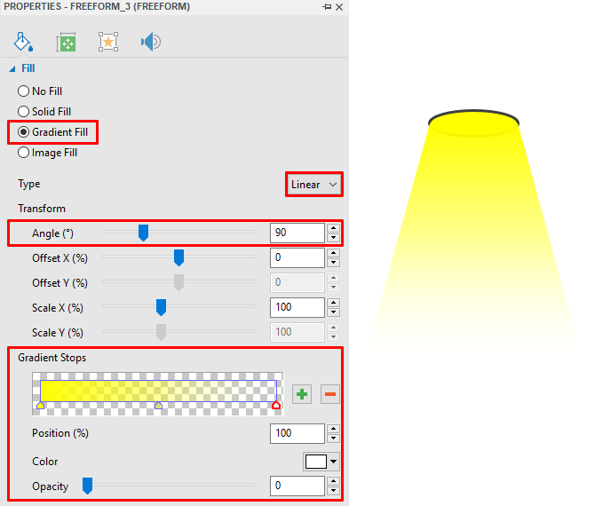

Step 2: Create the light beam. Perform the following:

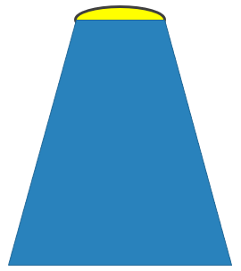

1. Draw a trapezium for the light beam using the Freeform Shape drawing tool. Then, place the light beam under the light source.
2. Switch from Solid Line to No Line.

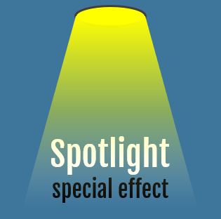

3. Change the fill color and reate a gradient fill for the light beam. In the Fill section, select Gradient Fill > Linear gradient type with a 90-degree angle (to make the fill direction straight). After that, add three gradient stops:
- Stop 1: Position 0%. Yellow. Opacity 255 (non-transparent).
- Stop 2: Position 50%. Yellow. Opacity 100 (semi-transparent).
- Stop 3: Position 100%. White. Opacity 0 (fully-transparent).
Now you can spotlight the object by placing it right under the light source, or make interesting effects like this:
