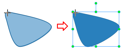

Drawing Freeform Shapes
Freeform Shape drawing tool has a dual capability to draw both straight and freeform lines. Perform the following steps:
Step 1: Click anywhere on the Canvas to set the start point. Now you can:
- Release the mouse button and place the cursor elsewhere, then click to draw a straight line.
- Hold down the mouse button and draw freeform lines.
Step 3: A freeform shape can be either open or closed. Do one of the following to finish your drawing:
- To draw an open shape, double-click at any time.
- To draw a closed shape, move the mouse near the start point and release the mouse button or left-click.
Note: You can alternate between straight and freeform segments within the same shape. While drawing, keep holding down the mouse button and move the mouse to draw freeform segments. Whenever you want to draw straight segments, release the mouse button. Simply move the mouse and click to set the end point of the straight segment. Then, keep holding down the mouse button and repeat the cycle.

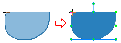

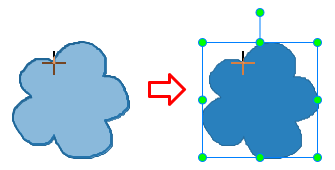

Drawing Freeform Scribbles
The Freeform Scribble tool is almost similar to the Freeform Shape tool as you can mimic drawing by hand. However, there is one essential difference. Once you start drawing a scribble, you have to keep holding down the mouse button until you finish. The point where you release the mouse button will be the end point of your drawing.
Step 1: Click anywhere on the Canvas to set the start point. Move the mouse without releasing the mouse button to draw the shape.
Step 2: To finish your drawing, just release the mouse button. If you want an open scribble, release the mouse button at any time. Otherwise, move the mouse near the start point and release it to get a closed scribble.

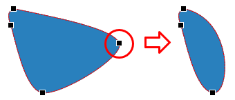

Editing Freeform

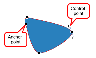

To edit a freeform drawing, right-click it > Edit Points to enter the edit mode. In the edit mode, the shape is outlined by a red dashed line containing multiple black squares. These black squares are anchor points which indicate the start and end of each line segment. When you select an anchor point, two blue handles appear with control points (white squares) at their ends.

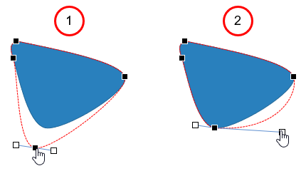

You can click and drag an anchor point (1) to sharpen or smooth a corner or curve. Alternatively, drag a control point (2) to change the degree of the curve or line. A red dashed line appears indicating changes.
Once you finish editing, click any elsewhere outside to exit the edit mode. Alternatively, right-click a shape no matter its outline, anchor points, or control points, and select Exit Edit Points.

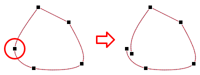

Adding and Removing Anchor Points
Right-click a freeform shape > Edit Points to enter the edit mode:
- To add an anchor point, click and drag the outline of the shape.
- To delete an anchor point, hold down CTRL and click it, or right-click it > Delete Point. The selected anchor point will disappear, making the shape change accordingly.

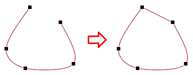

Opening and Closing Paths
In the edit mode of an open shape, right-click an anchor point > Close Path to close the shape. A linear path is added from the previous end point to the start point.
Otherwise, select Open Path to open a closed shape right at the selected point.
