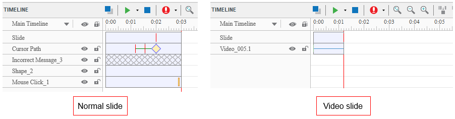

- As said earlier, after recording a software simulation, you’ll receive a project containing a series of slides. They can be normal or video slides. In the capturing phase, whenever you scroll the mouse or carry a drag-n-drop action, ActivePresenter automatically switches to the Full Motion Recording mode (Video) to capture it. Otherwise, the app switches back to the previous capture mode (Slide).
- ActivePresenter can automatically create slide names, smart annotations, cursor paths, mouse clicks, key strokes, text boxes, and feedback messages. Thus you can save yourself a lot of time and effort in the editing phase.
- In the normal slides, you may get the following objects: cursor path, incorrect messages, shape, and mouse click. But in the video slides, there is only one video object.

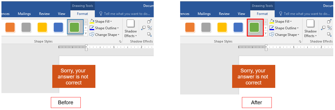

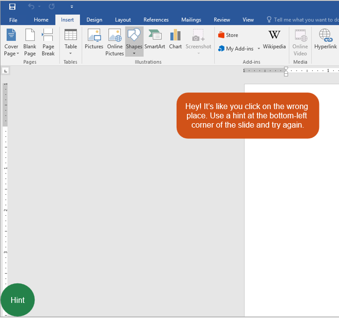

Add and Edit Feedback Messages
There are some feedback messages in ActivePresenter. They aim at showing how well users do a specific task. When you record software simulations, the app automatically generates some messages like incorrect messages. They are hidden initially and shown when the user action is incorrect.
You can add feedback messages to any project and customize them easily. To help you save time and effort, the app supports some practical commands like Add to Template, Set as Default Feedback Message, and Apply to All Feedback Message Objects. Using them, you can edit a feedback message, and then apply the change to others without editing one by one.
Note: ActivePresenter creates feedback messages (correct, incorrect, hover) for mouse clicks, key strokes, and text boxes. But by default, you see only the incorrect message after recording. So, remember to select them in the Recording Setting dialog before starting the capturing phase.
Tip: With feedback messages, you can free your creativity in many ways. For example, change the message in a user-friendly way like “Hey! It’s like you click on the wrong place. Use a hint at the bottom-right corner of the slide and try again”.

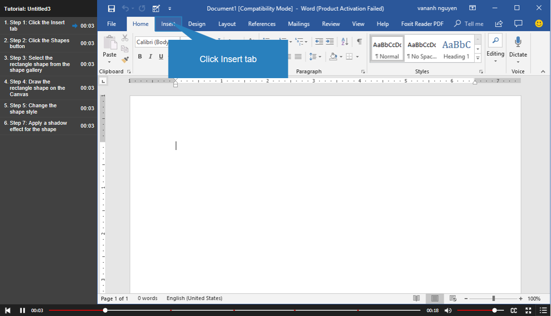

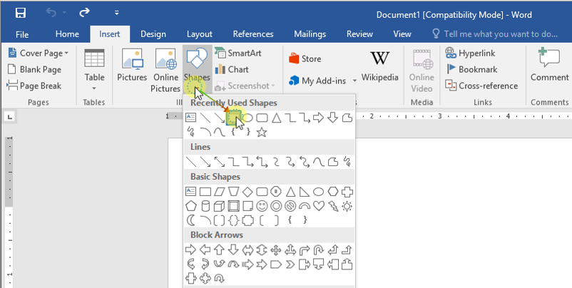

Edit Smart Annotations
When you make any click or press any key on the keyboard, ActivePresenter automatically creates shapes and add text to them. The texts show how you perform a step. They are called smart annotations.
To make a good software simulation, it’s better to customize the shapes. For example, you can type the step into a shape and place it at the bottom-right corner of the slide. Every time users look at it, they can know exactly what they have to do.
