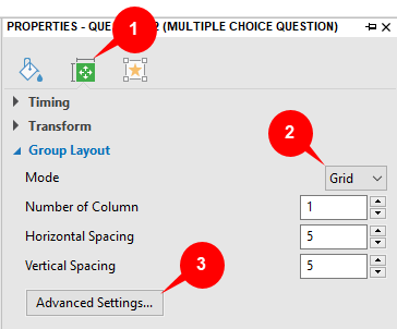

There are two modes in the group layout of questions which are Grid and None. To select the mode, take the following steps:
Step 1: Select the answer section of the question.
Step 2: Open the Size & Properties tab (1) of the Properties pane.
Step 3: Access the Group Layout section and select between Grid and None from the Mode list (2).

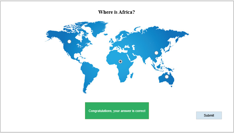

- None: When you select this mode, you are free to change the size and position of any object of a group just by dragging it.
You should select this mode if you need to create a quiz containing many clickable areas that are placed randomly on the slide. For example, using it in creating quizzes to test learners’ knowledge of geography.
- Grid: The object position is fixed and you cannot change the position and size of each object separately. You can only change the whole group together. However, you can define the number of columns and spacing between answers by adjusting values in the corresponding box.
- Number of Column: This is the number of columns in the answer section.
- Horizontal Spacing: The horizontal space between columns.
- Vertical Spacing: The vertical space between object rows.
After that, ActivePresenter will adjust the object group depending on the values that you define. You can change the position or scale the whole group, however, these values will remain unchanged.

If you want to have further advanced adjustments for the group layout of your quiz, click Advanced Settings… (3). This opens the following dialog. It allows you to define the specific proportion of each column and row of the object group.
