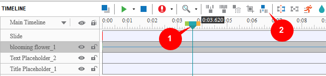

Step 2: Seek the Playhead (1) along the Timeline Ruler to the position where you want to pause the track.
Step 3: Click the Insert Time button (2) on the Timeline pane. This opens the Insert Time dialog:

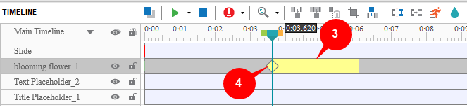

After that, ActivePresenter will insert time at the Playhead position. You will see a yellow bar (3) get superimposed on the audio/video object Time Bar. The yellow diamond (4) specifies the point that the track starts to pause. The duration of the bar is the freezing time of the track.

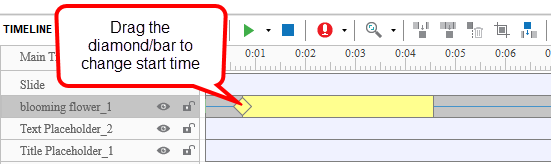

- Drag the whole bar or the yellow diamond along the Timeline Ruler to change the control start time:

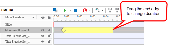

- Drag the end edge of the yellow bar to the right or left to increase or decrease the duration of the control respectively:

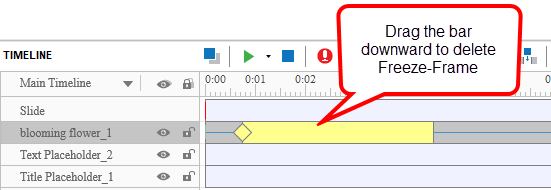

- Drag the yellow bar (3) of the Freeze-Frame downward. Keep dragging until the bar turns gray and release the mouse button:

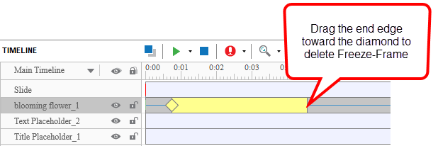

- Drag the end edge of the yellow bar toward the diamond. Keep dragging until two of them meet and release the mouse button:
After that, the pause will disappear and the duration of the host track will be reduced by the duration of the pause. The video/audio track will go back to its original properties.
