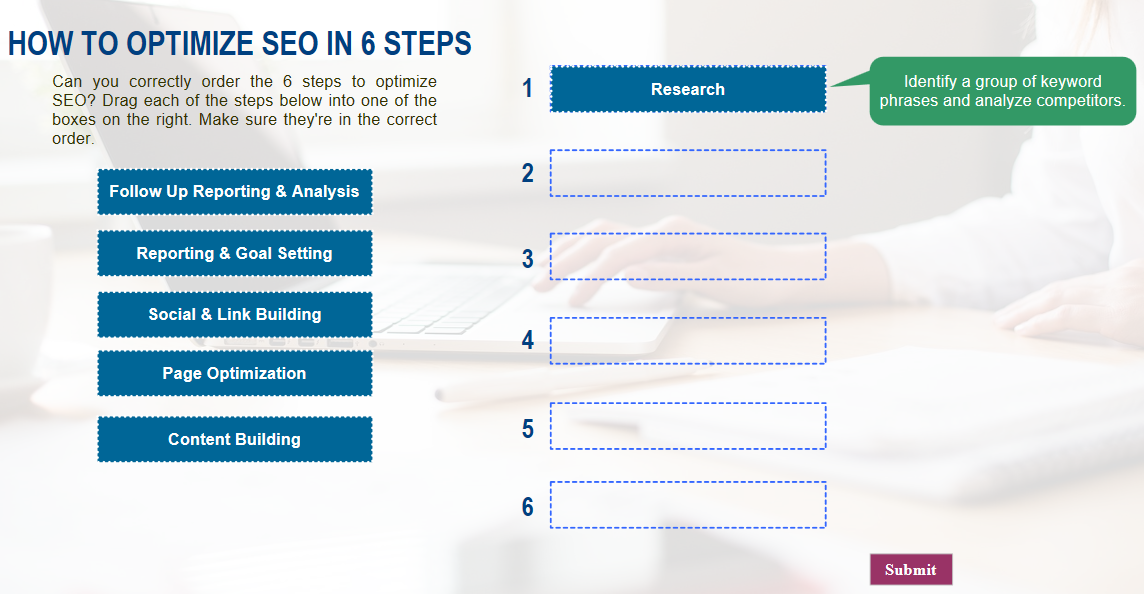

Text captions are useful to direct attention toward certain areas in a slide. Or, you can use them to give viewers extra information about important concepts. Here is an example of using text captions in an eLearning question.

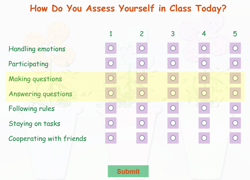

In ActivePresenter, a highlight object is a transparent, colored rectangle shape. You can place it over a certain area on a slide to draw attention to that area. Generally, highlight is also a variant of a shape object. But in that case, the text and border line are removed, and the background is made semi-transparent (50% transparency).
Below is an example of using a highlight in an eLearning question.
