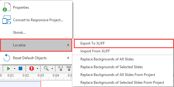

Step 2: Click Localize and then select Export to XLIFF from the context menu.
This opens the Export to XLIFF dialog as below.

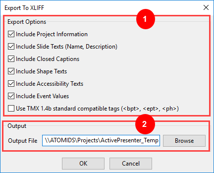

Step 3: Select types of text that you want to export for the translation in the Export Options section (1).
Select Use TMX 1.4b standard compatible tags (<bpt>, <ept>, <ph>) if your translation tool doesn’t support <g> and <x/> tag.
Step 4: Enter the output location and file name in the Output File box (2) and then click OK to start exporting to XLIFF.

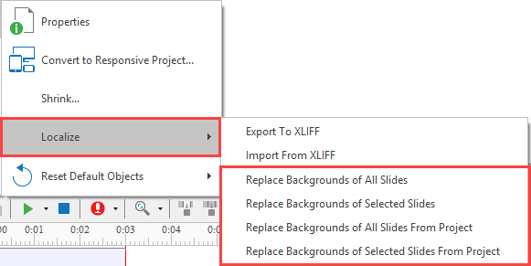

- Click the ActivePresenter button, select Project and then click Localize.
Then, you can do one of the four following ways:
- Select Replace Backgrounds of All Slides to replace all slides backgrounds with slides of the new captured project. Selecting this option will launch the blue rectangle and the Replace Slide Backgrounds dialog. After that, start to capture a new project as normal.
- Select Replace Backgrounds of Selected Slides to replace some selected slide backgrounds with slides of the new captured project. Selecting this option will also launch the blue rectangle and the Replace Slide Backgrounds dialog. Then, you can capture a new project as normal.
- Select Replace Backgrounds of All Slides From Project and browse the new project captured in step 2 (PowerPoint_es_captured.approj) to replace all slide backgrounds of the current project.
- Select Replace Backgrounds of Selected Slides From Project and browse the new project captured in step 2 (PowerPoint_es_captured.approj) to replace some selected slide backgrounds of the current project.

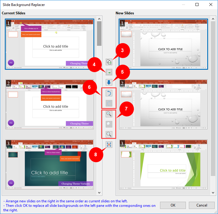

Step 4: In the Slide Background Replacer window, arrange new slides on the right in the same order as on the left.
To move a slide, drag and drop it to the new position.
- To delete a slide, select it and press the DELETE key. You can also right-click it and select Delete from the context menu. Besides, you are free to copy and paste slides in this dialog.
Note: You cannot delete slides of the copied projects through this dialog. You have to delete them directly in the project.
- If you are not sure that a new slide of the new project (on the right) is redundant or not, move it to the bottom instead of deleting it. To do that, select the slide and click the down arrow button (5).
- If a certain slide is required in the new language but not available in the original language, select it and click Copy To Left (3). This moves the selected slide from the right to the left.
- If you do not want to change a certain slide on the left (e.g. the introduction slide), just select it and click Insert PlaceHolder (4). This inserts a placeholder slide into the right.
- Along with pressing CTRL+Z, you can use Undo and Redo button (6) to undo or redo actions.
- Use three command buttons (7) to zoom in/out/fit the slides.
- In order to scroll the slides on the left and on the right separately, click the Disable/Enable Synchronous Scrolling (8).

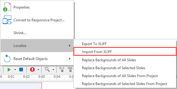

Step 3: Click Localize and then select Import From XLIFF.

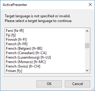

Step 4: Browse the translated XLIFF file and then select the new language, and click OK.
