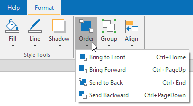

To change the stack order, do the following:
Step 1: Select one or more objects.
Step 2: Click the Format tab > Order or the Home tab > Arrange > Order. Alternatively, on the Canvas or in the timeline, right-click objects (time bars) > Display Order.
Step 3: Choose the desired display order options:
- Bring to Front (CTRL+HOME): Place the object at the very top of the stack.
- Bring Forward (CTRL+PAGE UP): Send the object higher by one level in the stack.
- Send to Back (CTRL+END): Place the object at the very bottom of the stack.
- Send Backward (CTRL+PAGE DOWN): Send the object lower by one level in the stack.
- These display order options let you set the z-order of objects even when they do not overlap each other. So, you can bring an object to the front or the back to easily identify and work on it.
- In the Selection pane, you can drag an object up or down to change its position in the stack order. Moving an object higher means that you bring it to the front of the stack.

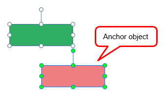

Aligning Objects with Anchor Objects
Sometimes, you have an object’s position set perfectly and you want to align other objects with that specific object. To do that, use the Alignment options and an anchor object. An anchor object (also a reference object) is the one with which all other objects align. It is the last object you select with green resizing handles rather than white handles like others. To define a different anchor object, click any of the currently selected objects without holding CTRL.
You have many options for aligning objects both vertically and horizontally. Do the following:
Step 1: Hold down CTRL while selecting all the objects that you want to align.
Step 2: Click the Home tab > Arrange or the Format tab > Align.

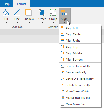

Step 3: Choose the desired alignment options:
- Align Left: Align the left side of all the objects with the left of the anchor object.
- Align Center: Align the center of all the objects with the vertical center of the anchor object.
- Align Right: Align the right side of all the objects with the right of the anchor object.
- Align Top: Align the top of all the objects with the top of the anchor object.
- Align Middle: Align the center of all the objects with the horizontal center of the anchor object.
- Align Bottom: Align the bottom of all the objects with the bottom of the anchor object.
Aligning Objects to the Canvas
You can align one or more objects to the center of the Canvas. Do the same steps to align objects as mentioned above, but choose either of the following:
- Center Horizontally: Move all the selected objects to the horizontal center of the Canvas.
- Center Vertically: Move all the selected objects to the vertical center of the Canvas.
Distributing Objects Evenly
If you arrange objects in a row or column, you may want them to be an equal distance from one another for a neater appearance. Do that by distributing the objects horizontally or vertically. Perform the same steps to align objects as mentioned above, but choose either of the following:
- Distribute Horizontally: Make the horizontal spacing equal between the selected objects.
- Distribute Vertically: Make the vertical spacing equal between the selected objects.
Note: These commands work only when you select more than two objects.
Resizing Objects to Anchor Objects
If you have multiple objects that you want to size equally, use the following alignment options:
- Make Same Width: Match the width of all the selected objects with that of the anchor object.
- Make Same Height: Match the height of all the selected objects with that of the anchor object.
- Make Same Size: Match the height and width of all the selected objects with those of the anchor object, respectively.
