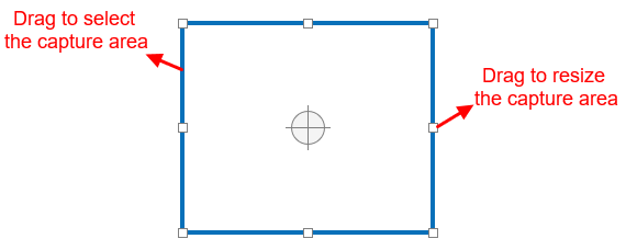

- A blue rectangle and a cross hair (in the middle of it) which indicate the capture area. ActivePresenter 7 will record actions that happen only inside this area. The rest of screen doesn’t appear in your recorded video.

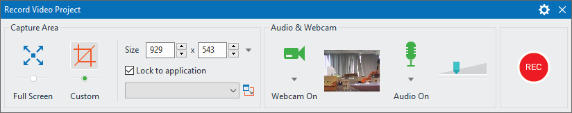

- A Record Video Project dialog. There are many things which can be done from here. For example, specify the capture area or open the Settings menu.

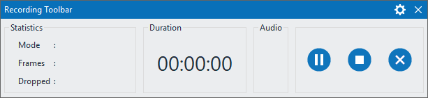

- A Recording Toolbar. This toolbar will appear if you early on select to show it (by clicking the gear button in the Record Video Project dialog). Normally, it isn’t shown by default. I’ll discuss this toolbar later.

ActivePresenter gives you two ways to specify the capture area. One is using the blue rectangle to do that manually. But if you want to have more options, just work with the Capture Area section in the Record Video Project dialog.
In the Record Video Project dialog, the Capture Area section is a useful feature. The name says it all. That is, this section offers two capture modes: Full Screen and Custom. Choose one of them to specify the capture area.

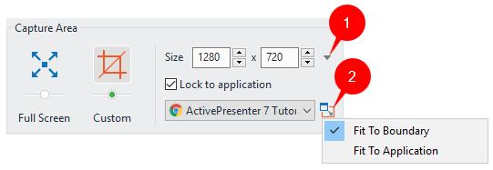

- Enter the width and height value in the Size spin boxes. Or, click the Preset Sizes button (1) to select a preset from the list.
- Select Lock to application check box to lock the blue rectangle to a specific application window. Then, no matter how you move or resize the target window, the capture area will follow.
- Click the Change Lock Mode button (2) to show two other options. The Fit To Boundary command resizes the application window to fit into the blue rectangle. On the contrary, the Fit To Application option resizes the blue rectangle to fit into the application window.

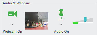

To set the webcam and audio, take a look at the Audio & Webcam section in the Record Video Project dialog. As you notice, the section has two commands. One is for recording webcam, and the other is for recording audio. You can select one of them or both.
- Webcam: Click Webcam to enable webcam recording. This is a very new feature in ActivePresenter 7, which allows you to have your face in the recorded video. So, your audience will not only view your screen but they also see you. When the webcam is on, a live preview of the camera appears next to the button.
- Audio: Click Audio to turn this recording option on. This feature comes with two commands to capture audio system and audio from microphone. In case of the latter, select one from the microphones detected to record. In addition, there is a volume scale next to the Audio command. Drag it to change the recording volume if you want.

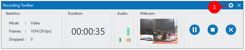

is also shown in the system tray. Click this icon to show the Recording Toolbar allowing you to stop recording and view the recording status.
- Statistics section: Give you information about the recording. That is, Mode is the current recording project mode (Video for the Record Video function). Frame is the current frame number of the recording. Meanwhile, Dropped indicates the number of missed frames of the recorded video.
- Duration section: Show the current duration of the recording.
- Audio section: Show the audio sound level.
- Webcam section: Show the live preview of webcam.
To hide any section as shown above, click the Settings button (3) to show the options. Then, unselect the section you don’t want to show.
Tip: When recording a partial screen, you can show the Recording Toolbar to view the statistic and easily pause or stop recording. Besides, it’s useful to display the webcam to get a live preview of yourself. Also, make sure you place this toolbar outside the blue rectangle or it will appear in the recorded video.
