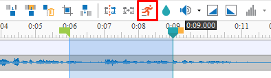

Sept 2: In the Timeline pane, click the Change Playback Speed button. This opens the following dialog:

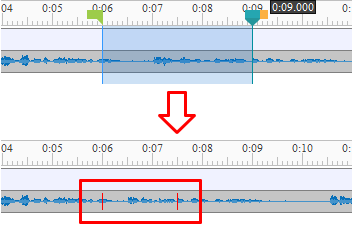

Step 4: Click OK to apply changes. If you change the playback speed of a range, two red marks will appear to show where the range starts and ends.
The following figure shows a range after doubling the playback speed (200%).
