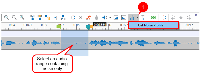

Step 1: Get Noise Profile.
- Specify the range that contains background noise only.
Note: If the selected range is too short, the app cannot get the Noise Profile. You must select a minimum 2048 samples, or about 0.05 seconds at 44100 Hz sample rate.
- Click the arrow button on the Audio Noise Reduction button (1), then select Get Noise Profile.
After that, Noise Profile will be stored in the program. When you close the program or replace it with another Noise Profile, it will be lost.
You can reduce noise for the whole audio track or just a part of it. In both cases, you have to specify the audio range containing noise only first. Then, select Get Noise Profile by clicking the arrow button on the Audio Noise Reduction button so that ActivePresenter can identify the noise in the audio. To reduce noise for the whole audio track, you need to do one more thing before moving to the step 2: double click anywhere on the time axis to choose the entire track instead of a range.

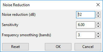

Step 2: Reduce noise.
After getting Noise Profile, you can apply Noise Reduction to a certain range in the audio track or to the entire file.
- Select the range or the audio tracks you want to apply Noise Reduction.
- Click the Audio Noise Reduction button
. Then, the Noise Reduction dialog will appear:
- Noise reduction (dB): Control the amount of volume reduction (0 – 48) applied to the identified noise.
Higher values reduce a higher amount of volume reduction, making the noise quieter but can distort the audio track. Keep this control as low as possible.
- Sensitivity: Control how much of the audio will be considered noise.
Greater sensitivity will remove more noise but can damage the track. Keep this control as low as possible.
- Frequency smoothing (bands): Spread the noise reduction into the specified number of neighboring bands.
Smoothing can make the desired audio less clear, so set the value to 0 if your desired signal is strong and the noise is low.
- Click OK to apply the effect and close the dialog.
If the Noise Reduction effect doesn’t work as well as you expected, you can press CTRL+Z and try Noise Reduction again with different settings. Note that you don’t have to get a new Noise Profile if you think the existing is good enough.
