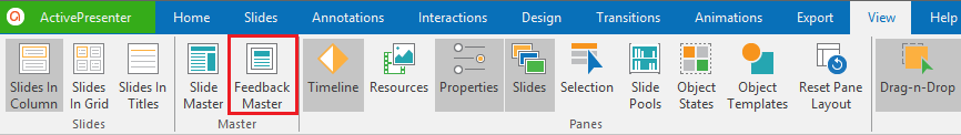

Basically, a feedback layer is almost the same as a slide layout. So, if you want to work with it, you have to open the Feedback Master View. Initially, open the View tab > Feedback Master.

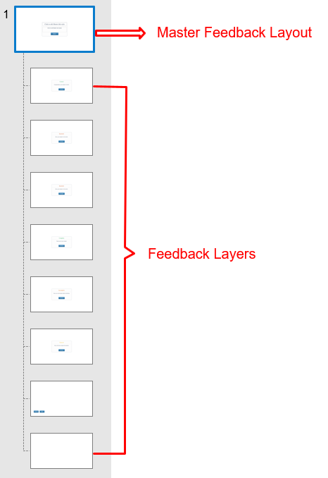

Then, the Feedback Master will appear in the left pane. By default, a feedback master includes 1 Master Feedback Layout and 8 built-in Feedback Layers.
- Correct Feedback: Used in the On Correct event to let users know their answers are correct.
- Incorrect Feedback: Used in the On Incorrect event if the current attempt is the last attempt, letting users know their answer is not correct.
- Try Again Feedback: Used in On Incorrect event if the current attempt is not the last attempt. The message lets users know their answer is not correct and they can try again.
- Complete Feedback: Used in the On Complete event to let users know they have completed the answer.
- Incomplete Feedback: Used in the On Incomplete event. The message lets users know they have to complete answering the task before moving to the next one.
- Timeout Feedback: Used in Timeout event. The message appears to let users know the time to do the task is run out.
- Review Feedback: This feedback layer is used in the review mode. It is triggered in the OnLoad event of the slide. You have to use the apReviewMode variable to check if the presentation is in the review mode or not. There are two buttons (Previous and Next) in this layer. They let users navigate the presentation when reviewing a course.

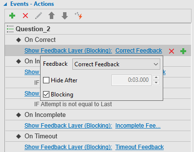

In the previous version of ActivePresenter, the default action of the On Correct, On Incorrect, On Complete, On Incomplete and On Timeout event shows a corresponding feedback message. For example, when users answer a question correctly, a correct message appears. However, in this version, those events have the default action which is Show Feedback Layer. For example, the default action of the On Correct event is Show Correct Feedback Layer.
When choosing Show Feedback Layer, you will have two options:
- Hide After: allows hiding the feedback layer after a period of time that you set.
- Blocking: allows blocking the main timeline when the feedback layer is showing.

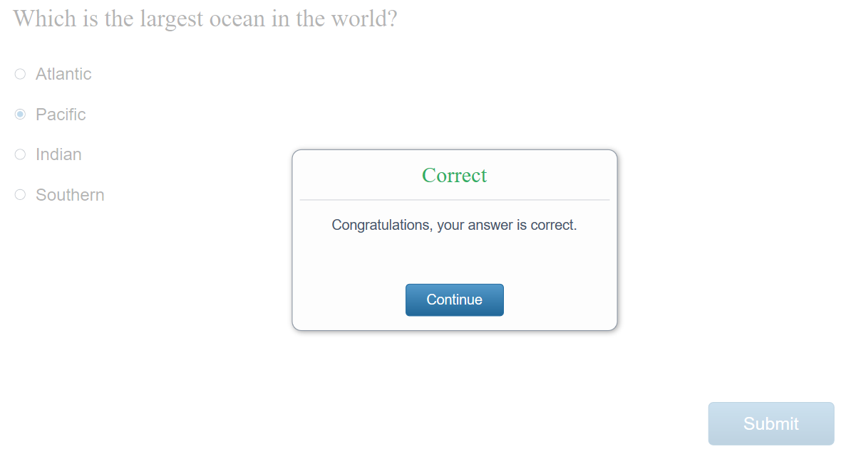

So, if your answer is correct, it allows showing the correct feedback. Now, see the below image for easy understanding:

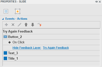

Besides, there is another action that is used directly from the action gallery: Hide Feedback Layer action. It allows hiding a feedback layer. For example, if your answer is incorrect and you are allowed to try again, the feedback will be hidden at once after clicking Try Again button.
That’s because Hide Feedback Layer action is already set up in the Try Again Feedback Layer. This below picture will show you more clearly:

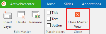

Step 4: Click Close Master View in the Feedback Master tab.

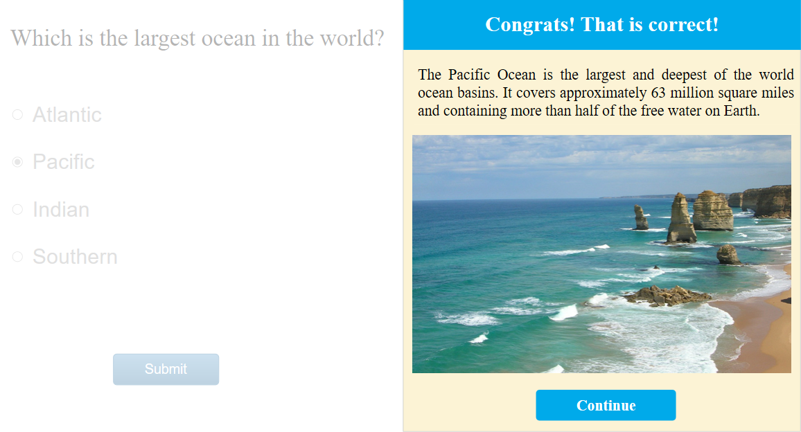

Step 5: Click HTML5 Preview to see the result:
After answering correctly, the picture with information about the Pacific Ocean presents on your screen.

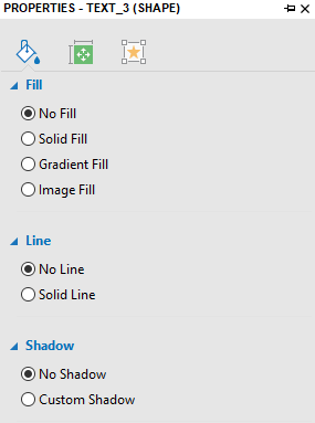

- To change the background style, open the Feedback Master View. Then, select the layout on the Canvas > Style & Effects tab on the Properties pane > change the Fill, Line and Shadow freely.

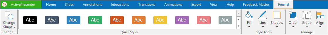

- To design the button of the layout, select the button > Format tab > change the shape, styles, etc., for the button.

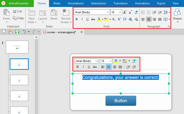

- To change the text font, size and color, select the text. Next, use the button and commands on the Home tab or the toolbar that appears.
