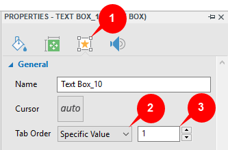

Step 1: Select the object.
Step 2: Open the Interactivity tab (1) of the Properties pane.
Step 3: In the General section, access Tab Order (2) and select one option from the list.
- Focusable Only: Objects are able to receive focus. However, they will not gain the tab focus.
- Auto: ActivePresenter will order objects automatically. When users press the TAB key, objects will be focused in a random order.
- Specific Value: Define a specific order for an object. Selecting this option, you have to specify the value in the Tab Order spin box (3). When users press the TAB key, objects will gain the tab focus in the order you’ve set.
- None: Select this if you don’t want to give objects any tab order.

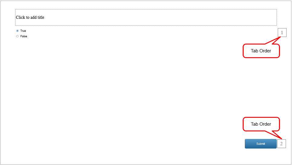

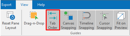

Show or Hide Tab Order Value on the Canvas
Open the View tab and select or deselect Tab Order to show or hide the tab order value on the Canvas respectively.
However, these values are only shown on the slide in the Editor but not in the output.

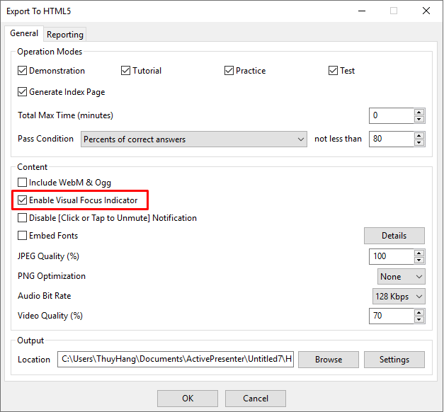

Enable the Visual Focus Indicator
When the object has focus, the object outline (dotted line) will display so that users can easily see it. However, you have to enable this feature. To do that:
Step 1: Open the Export tab, click HTML5
. This opens the Export To HTML5 dialog.
Step 2: In the General tab of the dialog, check the Enable Visual Focus Indicator check box.
