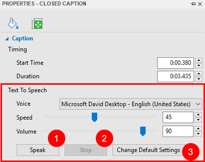

Step 1: Click the Properties pane > Sizes & Properties > Caption.
Step 2: In the Text To Speech part, specify the voice, speed, and volume for the CC line. Then, click Speak (1) to listen to the voice and click Stop (2) to stop listening.
Step 3: Optionally, click Change Default Settings (3) to change the default TTS settings in the Text To Speech dialog. Thereby, newly added CC lines will apply the new default TTS settings.

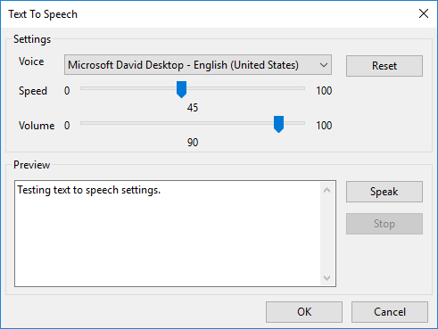

The Text To Speech dialog appears as follows:
To check the settings, enter a test sentence in the Preview text box first. Then, change the voice, speed, and volume, and click Speak to listen to the voice.
- If the results are not OK, change the parameters and try again. Repeat the cycle till you are satisfied.
- If your settings are not good enough, click Reset and start over.
- When you are satisfied, click OK to close the dialog.

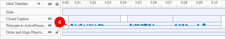

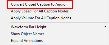

Step 4: After adjusting each CC line, go to the Timeline. Right-click one CC line and select Convert Closed Caption to Audio. This converts all CC lines in a slide into speech.

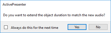

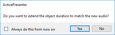

Step 5: After the conversion, ActivePresenter asks whether to extend the duration of the CC object to match the duration of the converted speech.
- Click Yes or No depending on your needs.
- Select Always do this from now on to remember your preferences.
Regardless of your choice, ActivePresenter will generate the audio and place it right below the CC object in the Timeline.

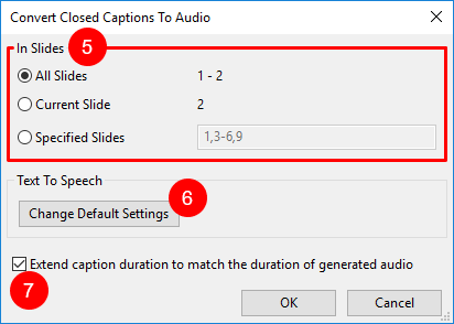

Step 1: Go to the Slide tab > Batch Operations > Convert Closed Captions To Audio.
A dialog appears as follows:
Step 2: Specify the slides (5) where you want to convert closed captions to audio. If you choose Specified Slides, separate the ordering numbers of slides by commas. Otherwise, use hyphens to indicate ranges. For example, the range 3-6 indicates the 3rd, 4th, 5th, and 6th slides.
Step 3: Click Change Default Settings (6) to change the default TTS settings in the Text To Speech dialog. These settings will be applied to all CC lines which are inserted afterward.
See the Step 3 in the previous part for details about changing the default TTS settings. Once you’re satisfied, click OK to close the dialog and back to the main dialog.
Step 4: In the main dialog, select Extend caption duration to match the duration of generated audio (7) if needed. This may cause sync problems, so you have to check out the project carefully.
Step 5: Click OK to create audio from closed captions.

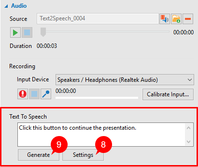

To create audio from text, take the following:
Step 1: Enter your text in the Text To Speech text box. If the object contains text such as shapes, text captions, the text will appear in this text box. However, you can freely change the text as you want.
Step 2: Click Settings (8) to adjust the TTS preferences. This opens the Text To Speech dialog where you can specify the voice, speed, and volume for the TTS audio.
Step 3: Once you’re satisfied, click Generate (9) to perform the conversion.
Step 4: When you generate TTS audio, the object duration can be shorter than the generated audio duration. In that case, ActivePresenter will ask whether you want to extend the object duration to match the duration of the generated audio.
Click Yes or No depending on your needs. You can select Always do this from now on to remember your preferences. Regardless of your choice, ActivePresenter will generate the audio and attach it to the object.

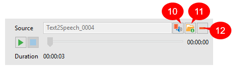

Note: If you want to remove the generated audio from the object, click Remove (12). ActivePresenter also allow you to attach audio from the current project (10) or from your computer (11) to your objects.
