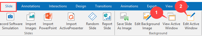

To view the Active Window, do one of the following:
- Open the Slide tab and click View Active Window (1).

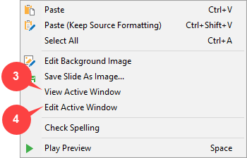

- Right-click anywhere on the Canvas and select View Active Window (3).

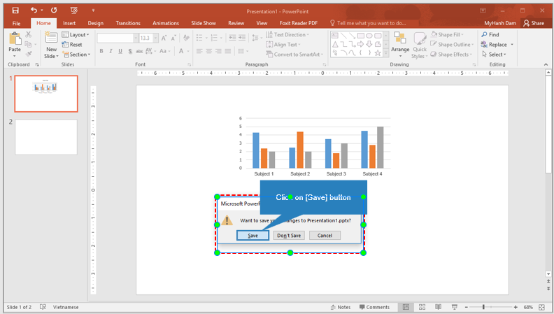

The screenshot below shows a captured slide that captures Microsoft PowerPoint. The Active Window area is shown in a red dashed border.
Tip: When recording software simulations, you can place the annotations that are automatically added during the capture inside the Active Window area. See Working with Recording Settings Dialog.

Sometimes, the Active Window area detected while capturing doesn’t fit the dialog/window. Don’t worry because you can modify this area. To edit the Active Window:
- Open the Slide tab and click Edit Active Window (2).
- Or, right-click anywhere on the Canvas and select Edit Active Window (4).
This enables the Edit Active Window tool, letting you resize the Active Window area by dragging its red dashed border.

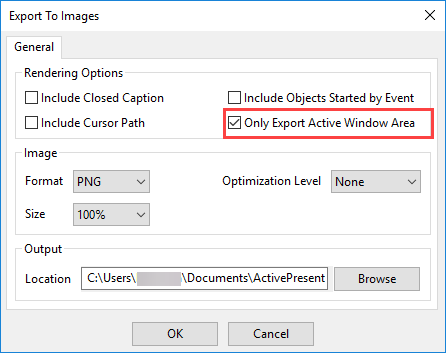

Export Active Window Area Only
When it comes to exporting projects to images, Microsoft PowerPoint or other document formats, you can choose to export only Active Window area. The exported images, PowerPoint slides, or document files will only include the Active Window area and slide objects that you select to export.
Step 1. Open the Export tab, select the format to which you want to export your project.
Step 2. In the corresponding dialog that pops up (e.g. Export to Images), select Only Export Active Window Area.
