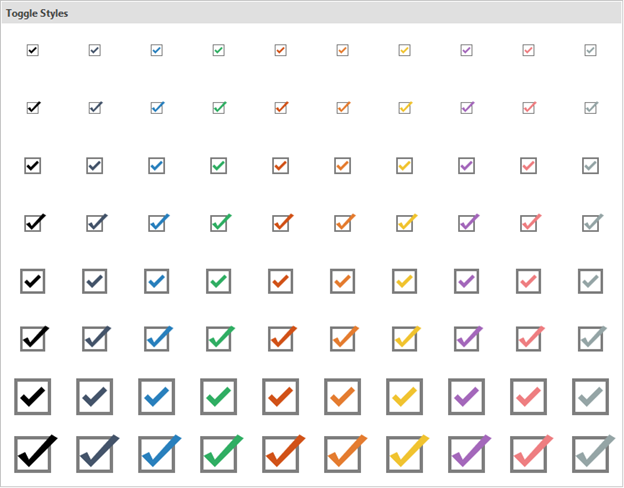

ActivePresenter offers a gallery of ready-made check box/radio button styles. Use these galleries to choose the style you want.

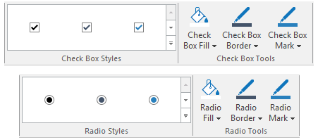

First, select the object. Then, in the Format tab, click one out of three following buttons to change the colors:
- Check Box/Radio Fill (1): Define the background color of the button.
- Check Box/Radio Mark (2): Define the color of the check mark or radio dot (when the button is checked).
- Check Box/Radio Border (3): Define the color and style of the border. Choose Width to change the border thickness.

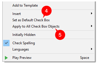

You can set a certain check box/radio button as the default style so that the same attributes will be applied to all the new check boxes/radio buttons in the same project. To do that, right-click a check box/radio button > Set as Default Check Box/Radio Button (4).
Note: This method only takes effect to newly added objects. If you want to apply the new default style to existing objects, right-click an object > Apply to All Check Box/Radio Button Objects (5) > Style.

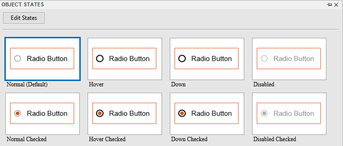

Check boxes and radio buttons come with eight built-in states which control their appearance when users interact with them. When you hover over the button or click it, the way it looks changes accordingly.
You can modify any of the built-in states and even create custom states. However, always ensure all states of the same button look consistent and make sense. For more details about states, see Working with Object States.

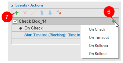

Add events and actions to make the buttons work. To do that, select a check box/radio button > Properties pane > Interactivity > Events – Actions.
The following four events are available:
- On Check: Occur when the button is marked.
- On Timeout: Occur when users don’t respond within the specified time.
- On Rollover: Occur when the mouse enters the boundary of the check box/radio button.
- On Rollout: Occur when the mouse exits the boundary of the check box/radio button.
To add events to a check box/radio button, first select it in the Events – Actions section. Then click the Add Event button (6 or 7) and choose an event from the pop-up list. Next, add actions to the event and preview. For more details about events and actions, see Working with Events – Actions.
