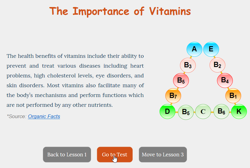

Using Object States is a good way to change the appearance of an object according to learner interaction. For example, zoom in a button or change its color when learners hover over it. Besides, ActivePresenter allows you to add as many states as you want. Keep in mind that Objects States aren’t available for object groups.

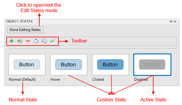

Basically, a state is a collection of visual elements defining the look and feel of an object. In ActivePresenter, most objects support states, except for Zoom-n-Pan, Cursor Path, and Closed Caption. Some objects have only one state while others have multiple default states. To view all states of an object, you need to access the Object States pane. Here you’re given a toolbar with a lot of commands to edit states and a button to open the Edit States mode. Let’s take a look at states of the Button object. This is a typical example of an object having many states. As you can see, this object has four default states: Normal, Hover, Clicked, and Disabled.- Normal: By default, it’s the initial state of an object when it first appears in the output. Note that the initial state can be changed.
- Hover: This is how the object appears when learners hover over it.
- Clicked: This is how the object appears when learners click it.
- Disabled: A disabled object is still visible to learners, but it won’t respond when hovered, clicked, or dragged. Unless you set it as the initial state, you’ll need to use a trigger to show this state.
- Normal state: Each object always has a Normal state, and you can’t delete or rename it. But you’re able to customize this state like its color and size.
- Custom state: An object may have multiple Custom states. They can inherit visual properties from the Normal state. In the case of the Button object, Custom states are Hover, Clicked, and Disabled.
- Default state: The Normal state is the Default state by default. You can set any other state as a Default one.
- Active state: During the Edit States mode, the state you selected is the Active state. When the first time you access this mode, the Normal state is the Active state.

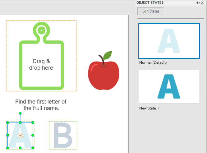

An object has at least one state by default. To add extra states, do the following: Step 1: Select an object. Step 2: In the View tab > Object States
- If you don’t select an object, the Edit State button is unavailable.
- When you’re in the Edit States mode, all other objects in the current slide will be grayed out and unclickable.

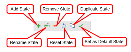

ActivePresenter 7 offers you some commands to manage object states. These commands are placed in the toolbar, or you can right-click a state to see them.-
- Remove State: Delete the selected state.
- Duplicate State: Duplicate the selected state. The new state has the same properties as the original.
- Rename State: Select this to rename the selected state. After that, you’ll see the name at the bottom-left corner of the state thumbnail.
- Reset State: Restore the original state if you aren’t satisfied after editing the selected state.
- Set State as Default: Select this to label the selected state as a default.

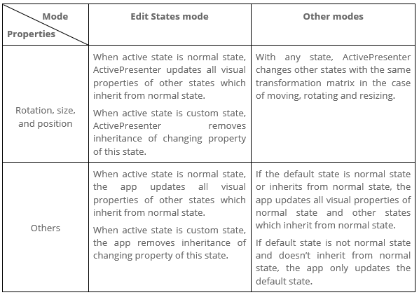

- When changing visual properties of a state, consider these constraints:
