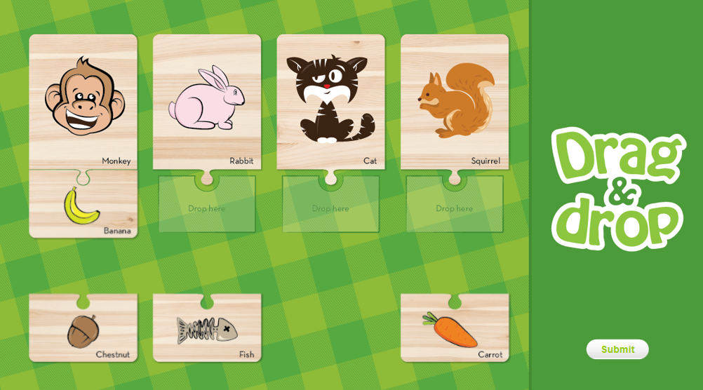

Using Drag-n-Drop question is a good way to create drag-n-drop interactions. In a word, a Drag-n-Drop question is a type of eLearning questions. It includes multiple drag sources and drop targets that require learners to match correctly. Below is a typical example of a drag-n-drop interaction created with Drag-n-Drop question.
A Drag-n-Drop question created in ActivePresenter 7

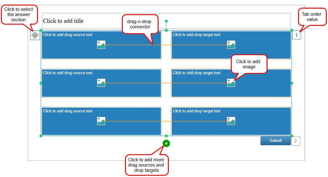

Then, the default Drag-n-Drop question appears like the screenshot below. Note that when you click this button, the app creates a new slide as a Drag-n-Drop question slide.
Regarding drag sources and drop targets, mind the following:
- Each drag source and drop target is a shape with a clickable Image button
inside. Use this button to add images. Or, click the default text to add your text. - An object as a drag source has a light green dashed boundary. Meanwhile, an object as a drop target has an orange dashed boundary. This boundary doesn’t appear in any output format but the editor.
- There are orange drag-drop connectors which connect the drag sources to the drop targets. They denote that dropping the drag source to the drop target is a correct action. They appear by default but you can hide them by clicking Drag-n-Drop
in the View tab. - A drop target can accept one or multiple drag sources.
- If there is more than one accepted drag source, they may overlap each other when learners drop them into a drop target. To avoid this, you need to adjust the position and direction of the drop target. (For example, change the position to Tile and the direction to From Top, Left to Right.)
- You can set an object as drop target or turn a drag source into a drop target. But you can’t do these things with a drop area.
- Feedback messages include Correct, Incorrect, Complete, Incomplete, and Timeout depending on the mode you select for the question (Graded or Survey) and only appear in the output. They can be customized in the Feedback Master command in the View tab.
- To edit Submit button, you should use Slide Masters.
- To change the tab order value, use the Tab Order feature.

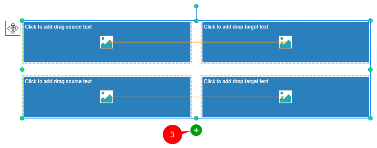

- Add drag sources and drop targets: Select the question and click the green button (3). After that, a new drag source and drop target pair is added towards the bottom. It’s good to rename drag sources and drop targets. This will help you identify them easily in many places.

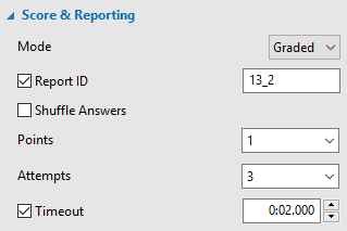

Step 2: In the Properties pane > Interactivity > Score & Reporting. Then, you see the following options:
From here, you can do many tasks. For example, select the question mode. If you want to assess learner performance, select Graded. In case of collecting feedback, go with Survey. Besides, you’re free to shuffle answers and set points, number of attempts, and timeout. See Creating Quizzes to learn the procedure.

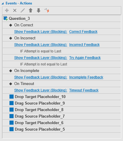

The Drag-n-Drop question comes with events having default actions that show the corresponding feedback layer. There are four events (On Correct, On Incorrect, On Incomplete, and On Timeout) in the Graded mode and three events (On Complete, On Incomplete and On Timeout) in the Survey mode.
Below is the default events-actions in the Graded mode. (Select the answer section > Properties pane > Interactivity > Events – Actions).
You can customize the events-actions as you wish. For the procedure, see Working with Events – Actions.
Note: In terms of drag sources and drop targets, do the steps above to insert events – actions into them. But first, remember to select a drag source/drop target instead of the question.
