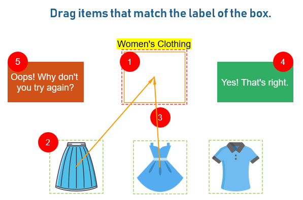

Drop Area is suitable for creating drag-n-drop interactions. These interactions work the same way as when you drag a file into a folder to copy it. But instead of the file, you now drag an object and drop it into another. Below is a typical example of a drag-n-drop interaction created with Drop Area.

- A Drop Area object gives you a drop area (1) where you can drag one or more objects as drag sources (2) onto it, like the example above.
- An object as a drag source has a light green marker. Meanwhile, an object as a drop area has a light red marker. This marker doesn’t appear in any output format but the editor.
- There’s an orange drag-drop connector (3) which connects drag source with the drop area. This connector denotes that dropping the drag source to the drop area is a correct action. For this reason, it appears only when you drag the drag source to the drop area.
- Correct and Incorrect messages (4, 5) are feedback messages automatically created by ActivePresenter. But you can add other feedback messages like Timeout and Hint; then, customize them if you like.

A Drop Area object includes five default elements: a drop area (with light red marker), a drag source (with light green marker), a drag-n-drop connector (an orrange arrow), a Correct message, and an Incorrect message. Note that you can make the markers and the drag-n-drop connector shown or hidden by clicking the Drag-n-Drop button in the View tab. You can also customize these elements and add as many drag sources you want.
