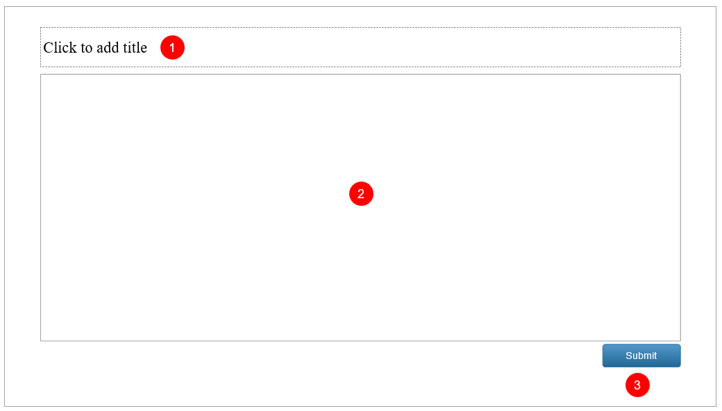

An Essay question contains a multiple-line text box that allows learners to input text. At this point, don’t confuse this question type with Fill in Blank questions. Fill in Blank questions also have only one text box, however, this text box has only one line.
An Essay Question created in ActivePresenter 7

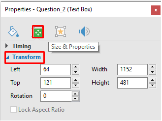

Here are some ways to customize the Essay question:- Resize the question: Select the whole question and drag the resizing handles. Otherwise, access the Properties pane > Size & Properties > Transform > adjust or type values in the boxes (Left, Top, Width, Height, and Rotation).

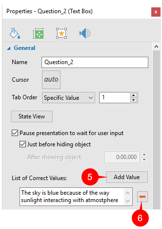

Set Correct Answers

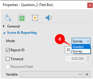

By default, the Survey mode is selected in the Score & Reporting section for Essay questions. In this mode, you can’t set correct answers. To set correct answers, you need to select the Graded mode. Do as follows: Step 1: In the Properties pane > Interactivity > Score & Reporting. Select Graded from the Mode drop-down list (4).

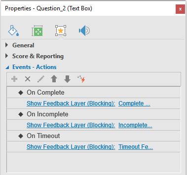

Essay questions have three defaults events and actions for the Graded mode, which are On Correct, On Incorrect, and On Incomplete. With the Survey mode, its three defaults events and actions are On Complete, On Incomplete, and On Timeout. If you’ve selected the Survey mode early on, this is what you’ll see:
