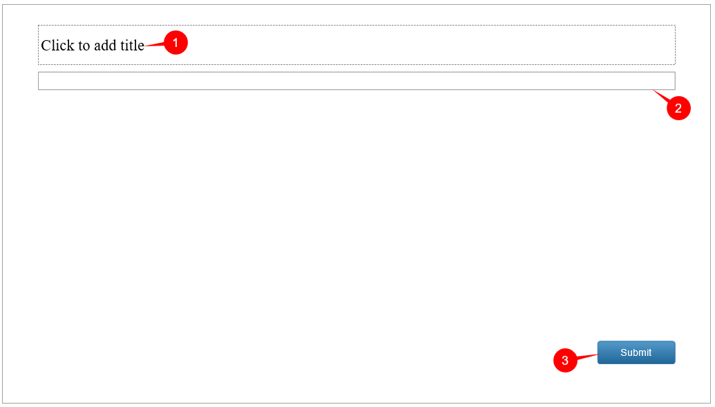

Then, a new question slide appears in your project:
A Fill in Blank question has three parts. The top text box (1) is where to add the question title. The answer area (2) is represented by an one-line text box. The Submit button helps learners to submit their answer.

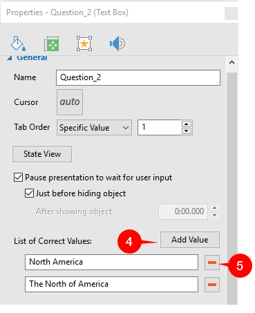

Set Correct Answer
ActivePresenter allows you to set more than one correct answer. Follow these steps:
Step 1: In the Properties pane > Interactivity > General.
Step 2: Click Add Value (4) to display a blank box. If you want to have more than one box, just click the button as many times as you want. Then, type correct answer(s) for the question into the box(es).
To delete any answer, click Remove (5).
Tip:
- You can type anything in the box, from alphabet to special characters.
- Apart from typing the answer, you can copy and paste text from other places in the box.

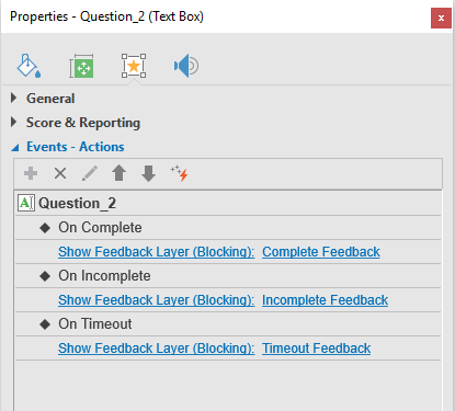

Add Events – Actions
Like other question types, ActivePresenter also offers default events and actions for Fill in Blank questions. Generally, this question type has four default events for the Graded mode (On Correct, On Incorrect, On Incomplete, and On Timeout) and three for the Survey mode (On Complete, On Incomplete, and On Timeout).
If you’ve selected the Survey mode, here what you’ll see:
You can remove, change, or make events and actions for this question more advanced as you wish. To do that, first, select the answer area. Then, access the Properties pane > Interactivity > Events – Actions. See Working with Events – Actions to learn more.
