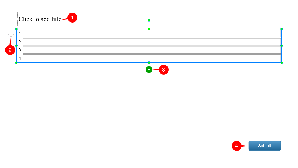

Then, a new slide with a Fill in Multiple Blanks question appears as below:
Like other question slides in ActivePresenter, a Fill in Multiple Blanks question slide has thee parts: the top text box (1), the answer area (2), the Submit button (4). The top text box is where to add the question title. Meanwhile, the answer area consists of four blanks (text boxes) by default. The Submit button is located in the bottom left corner in the slide.

- Add more blanks: As mentioned above, Fill in Multiple Blanks Questions have four default blanks in the answer area. To add more, just select the answer area and simply click the green circle button (3).
- Delete a blank: Select a blank and press DELETE on your keyboard. Alternatively, you can right-click the blank and select Delete.

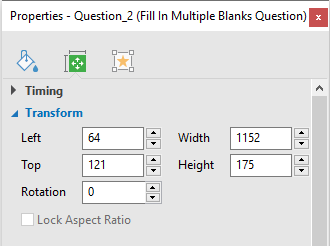

- Resize the question: Select the whole question and drag the resizing handles. Otherwise, access the Properties pane > Size & Properties > Transform > adjust or type values in the boxes (Left, Top, Width, Height, and Rotation).

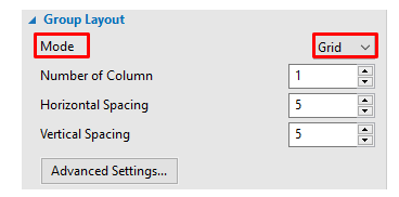

- Change question layout: At first, select the answer area. Then, go to the Properties pane > Size & Properties > Group Layout. You will see that the Grid mode is always selected by default. With this mode, you can change the layout by customizing its properties such as Number of Column, Horizontal Spacing, Vertical Spacing, and other Advanced Settings. However, if you select the None mode, these properties are faded and cannot be adjusted. The reason for that is the None mode allows you to freely change the size and position of any blank just by dragging it. See Group Layout of Questions for more details.

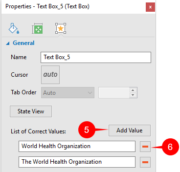

Set Correct Answer
To set a correct answer for each blank, first select a blank. Then, follow the steps below.
Step 1: In the Properties pane > Interactivity > General.
Step 2: Click Add Value (5) to show a blank box. Then, type the correct answer into this box.
Keep in mind that you can set as many correct answers as you wish for each blank. To do that, perform Step 2 again and again.
To delete any answer, click Remove (6).
Tip:
- You can type anything in the box, from alphabet to special characters.
- Apart from typing the answer, you can copy and paste text from other places in the box.

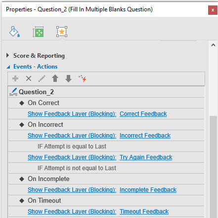

Add Events – Actions
Fill in Multiple Blanks questions have default events and actions. Generally, a Fill in Multiple Blanks question has four events for the Graded mode. The are On Correct, On Incorrect, On Incomplete, and On Timeout. With the Survey mode, it has three built-in events and actions, including On Complete, On Incomplete, and On Timeout.
In spite of those default events and actions, ActivePresenter allows you to delete them, change them, make them more advanced as you wish. To do that, select the answer area early on. Then, go to the Properties pane > Interactivity > Events – Actions. See Working with Events – Actions to learn more.
Insert Feedback Messages
ActivePresenter offers default feedback messages which correspond to the default events and actions mentioned above. Specifically, these default feedback messages can be Correct Feedback, Incorrect Feedback, Try Again Feedback, Incomplete Feedback, and Timeout Feedback (for the Graded mode) or Complete Feedback, Incomplete Feedback, and Timeout Feedback (for the Survey mode).
However, you’re free to remove them or add more if you want. See Working with Feedback Messages to get more details.
