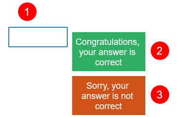

By default, a mouse click object consists of three separate elements: (1) a target area, (2) a Correct message, and (3) an Incorrect message.
When the interactive presentation is played, it displays only the target area (1) and waits for users to click anywhere on the slide. If users click the target area, the Correct message (2) appears, otherwise the Incorrect message (3) appears. You can prompt users to click on a specific area by inserting a shape with some guidance.

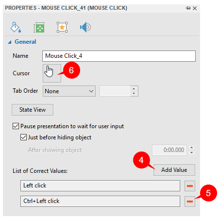

Step 3: Place the cursor over the Correct Value box and click the mouse button with or without the modifier keys to define a value.
If you don’t want a correct value anymore, click the Remove button (5) next to that value to remove it.
Besides, it’s great to let users know there is a clickable area on screen. For this reason, change the cursor for the target area to a hand cursor (6). That way, the mouse pointer will turn into a hand cursor when it’s over the correct area in the output.

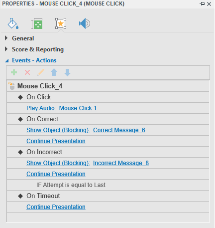

By default, mouse clicks have four events, namely On Click, On Correct, On Incorrect, and On Timeout. You can add two other events, namely On Rollover and On Rollout. These events are helpful when you want to create the hover effect.

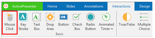

To insert a mouse click, click the Interactions tab > Mouse Click. Alternatively, click the Home tab > Interactions > Mouse Click.

Mouse click objects accept three types of mouse clicks (left-click, right-click, and left double-click) with or without modifier keys (SHIFT, CTRL, and ALT). To define a correct action, do the following: Step 1: Select the target area (1). Step 2: Click the Properties pane > Interactivity > General > List of Correct Values > Add Value (4).

To set up events and actions, access the Events – Actions section in the Interactivity tab of the Properties pane.
