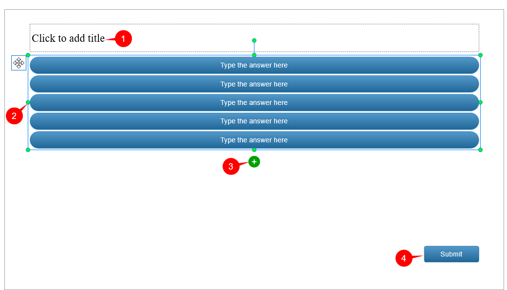

You can customize a Sequence question by following one or more option(s) below:- Add more answer labels: Select the answer area (2) and click the green circle button (3) to add more.

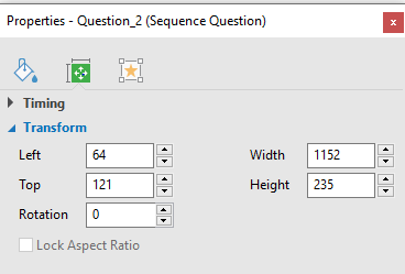

- Resize the question: Select the whole question and drag the resizing handles. Alternatively, access the Properties pane > Size & Properties > Transform > type values in the Width and Height boxes. When you’re done with this, if you want to restore the original size, right-click the question and select Reset Placeholder.

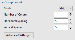

- Change question layout: At first, select the answer area. Then, go to the Properties pane > Size & Properties > Group Layout. You will see that the Grid mode is always selected by default. With this mode, you can change the layout by customizing its properties such as Number of Column, Horizontal Spacing, Vertical Spacing, and other Advanced Settings. However, if you select the None mode, these properties are faded and cannot be adjusted. The reason for that is the None mode allows you to freely change the size and position of any answer label just by dragging it. See Group Layout of Questions for more details.

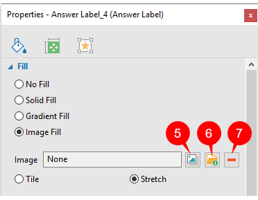

- Add images to answer labels: Click any answer label. Then, in the Properties pane > Style & Effects > Fill > Image Fill. Click Select a background image from project (5) to insert an image from the current project. Or, click Import a background image from your computer (6) to import an image from your computer. If you want to remove it, simply click Remove the background image (7).

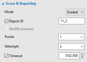

To set the correct answer for a Sequence question, just drag and drop answer labels in the correct order. Kindly be noted that in the output, answer labels are shuffled randomly each time learners take the question.Set Score & Reporting
To set scores and reporting for a Sequence question, select the answer area first. Then, go to the Properties pane > Interactivity > Score & Reporting:

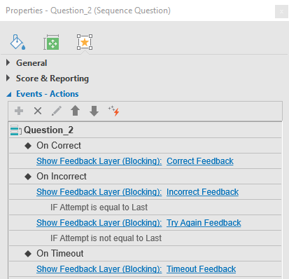

Sequence questions have default events and actions. In the Graded mode, a Sequence question has three events: On Correct, On Incorrect, and On Timeout. However, it just has two events in the Survey mode, which are On Complete and On Timeout. If you’ve selected the Graded mode early on, this is what you’ll see:
