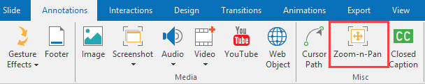

Step 1: Insert a zoom-n-pan object.
To insert a zoom-n-pan to zoom in a particular part of screen, open the Annotations tab and click Zoom-n-Pan.

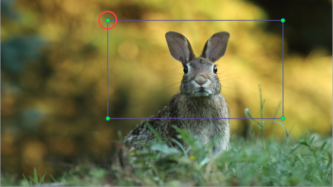

Then, you will see the zoom-n-pan rectangle appear on the Canvas with four green handles.

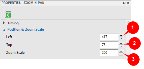

- In the Position & Zoom Scale section on the Properties pane, change the values in the Left (1) and Top spin box (2). This way provides more precise positions of the zoom effect on the slide, in which:
- Left: X position of the zoom rectangle from the left side.
- Top: Y position of the zoom rectangle from the top side.
Step 3: Change the zoom scale.
In order to change the zoom scale (the zoom rectangle size), do one of the following:
- Hover the mouse over one of the four green handles until the mouse turns into a two-headed arrow, then drag the handle.
- In the Position & Zoom Scale section on the Properties pane, enter a value in the Zoom Scale spin box (3). Also, this way provides a more precise zoom scale.

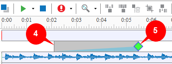

Step 4: Change the zoom effect start time.
The zoom effect will start to zoom in at the starting point of the object (4) and end at the green diamond (5). The light blue area inside the object Time Bar indicates the effect timing.
To change the start time of the zoom effect, do one of the following:
- Hover the mouse over the zoom effect object Time Bar until the mouse turns to a four-way arrow, drag it the to the left or right. Besides, you can drag the starting point (4) to change the effect start time. However, using this way will change the effect duration at the same time.

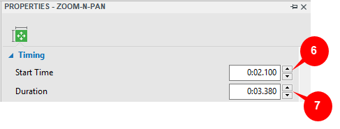

- In the Timing section of the Properties pane, enter a value in the Start Time spin box (6).

By default, the duration of the zoom-n-pan effect is one second and you can change it to any other values. However, you shouldn’t let this value be too short or too long because it might cause the zoom in and out to appear in hurry or disjoint. Two or three seconds are good to go since a smooth and unhurried effect is better for viewers to follow.
To change the zoom effect duration, do one of the two following ways:
- Drag the green diamond to the left or right to decrease or increase the duration respectively.
- In the Timing section of the Properties pane, enter a value in the Duration spin box (7).
