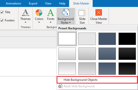

Besides, you can hide the logo in some custom layouts by selecting the layout > Background Styles > Hide Background Objects.

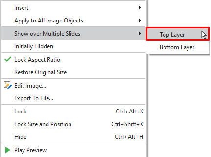

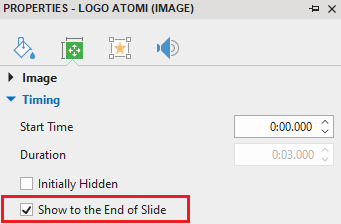

Step 1: Insert your logo into a slide (Insert tab > Image). Your logo automatically shows to the end of the slide (Properties pane > Size & Properties > Timing > Show to the End of Slide). Then, you are free to resize and reposition the logo as you want.
Step 2: Right-click the logo > Show over Multiple Slides. Next, choose to place the logo in the top or bottom layer of the object stack order.
After that, you can see a small icon that appears next to the logo name in the Timeline pane. It indicates that the logo is displayed over multiple slides.
At this point, the logo appears in all the slides starting from the current slide. This is due to the Show to the End of Project option (right-click the logo time bar > Show to the End of Project). So, if you inserted the logo into the first slide, then it would show over all the slides in the project. And your work is done here. That said, you can totally decide in which slides your logo will appear. Take these additional steps:
