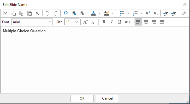

You can further format the style of the slide name or description by clicking the Edit buttons next to the text boxes. Then, a rich text editor will appear:
As you can see, this editor contains a lot of commands to style slide names or descriptions. So, keep in mind this feature in case you want to change the formats.

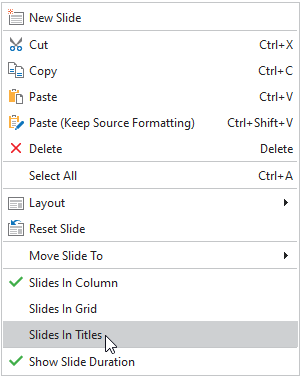

Step 1: Change the view mode of the Slides pane to Slides in Titles by right-clicking the Slides pane, and then clicking Slides in Titles.
Step 2: Double-click each entry. Alternatively, you can right-click an entry, and then click Edit Name to name a slide.

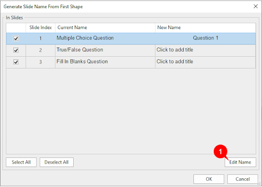

Another way to name slides is by using a batch operation that generates slide names from the first shape in each slide. This is useful when you want to name slides in a software simulation. Do the following:
Step 1: Click the ActivePresenter button > Project > Batch Operations > Generate Slide Name From First Shape.
This dialog includes:
- The Slide Index represents the slide numbers.
- The Current Name displays the current name of each slide.
- The New Name shows the text inside the first shape of each slide
Step 2: To rename a slide, double-click a name in the New Name column. Or, select any row, then click Edit Name (1). Make sure that the corresponding check box is ticked if you want to apply the change.
Step 3: Click OK to close the dialog and apply the changes.

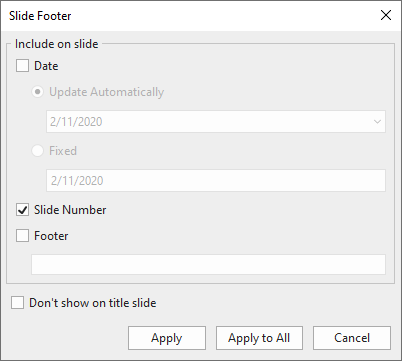

Footer allows you to add dates, slide numbers, and text to the bottom of a slide. To insert a footer, do the following steps:
Step 1: Select a slide in the Slides pane on the left side.
Step 2: In the Insert tab > Footer. This shows the Slide Footer dialog.
Step 3: Select the Slide Number check box. If you don’t want to show the slide number in the title slide, select Don’t show on title slide.
Step 4: Click Apply to insert a number to the selected slide. This number is also the one you see at the bottom-right of the slide in the Slides pane.
Or, click Apply to All to add numbers to all slides in the current project.

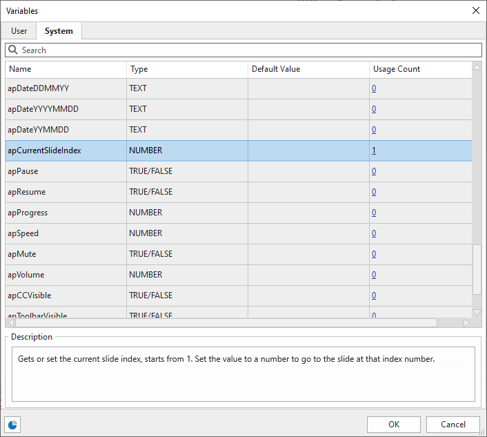

Another way to change slide numbers is by using Variables. Just use the “appCurrentSlideIndex” system variable and insert it into a shape or text caption to show the current slide number.
Step 1: Insert a text caption (or a shape) to the first slide that you want to add the number. You need to click the Insert tab and then click Text Caption (or Shape).
Step 2: Add variable to the text caption. In the Home tab, click Reference, and then select apCurrentSlideIndex in the system tab of the Variables dialog.
Step 3: Click OK to close the dialog and apply the variable to the slide.
