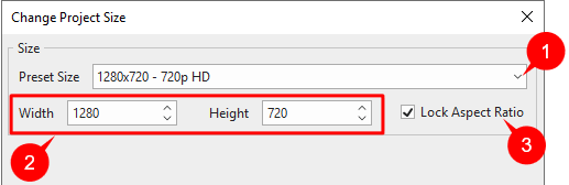

Step 2: Click Slide Size . This opens the Change Project Size dialog, take one of the following ways to select the new size:
- Quickly apply one slide size from the Preset Size drop-down list (1). The list contains different sizes ranging from small to large.
- Enter values in the Width and Height spin box (2).
Note: Regardless of the way you choose, the new project size can be smaller or larger than the previous size. In each case, you can have further options to adjust the contents of the slides. We will talk more about them in the next part of this article.
Step 3 (Optional): Check the Lock Aspect Ratio check box (3) if you want to keep the ratio between the width and the height of the slide size.
By selecting this check box, ActivePresenter will automatically change the height according to the width, and vice versa so that the aspect ratio can be maintained.

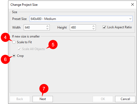

If you use the new size that is smaller than the previous one, ActivePresenter offers two options: Scale or Crop the contents.
Scale Contents
- Scale to Fit (4): If you want to scale the content, click this button. The slide will be scaled to fit the new slide size.
- Scale All Objects (5): When you select this check box, all of the objects in the slide will be scaled to fit the new slide size, including placeholders in slides and Slide Masters.
Note: If you select Scale to Fit but don’t select Scale All Objects, the slide is scaled; however, all of the objects in the slide still keep their original sizes which are sometimes too large in comparison with the new slide size. You can adjust their sizes after that.

Step 1: Click the Crop button (6).
Step 2: Click the Next button (7). This opens the following dialog:

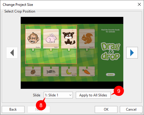

Step 3: Drag the orange frame to the desired portion that you want to keep. The area outside of the orange frame will be trimmed off.
ActivePresenter allows you to crop each slide individually or all of them at once:
- Crop each slide individually: Select the slide from the Slide list (8). You can also click the left arrow buttonor right arrow button to select slides one by one. After selecting, drag the orange frame to the desired position and click OK.
- Crop all slides at once: Select any slide of the project, drag the orange frame to the desired position, and then click the Apply to All Slides button (9). Click OK and all slides will be cropped at the same position.
Note: When you choose to crop the slide in any position, objects and placeholders of the slide or Slide Master will not be cut. They keep their original sizes and you can manually drag their handles to fit the new slide size.

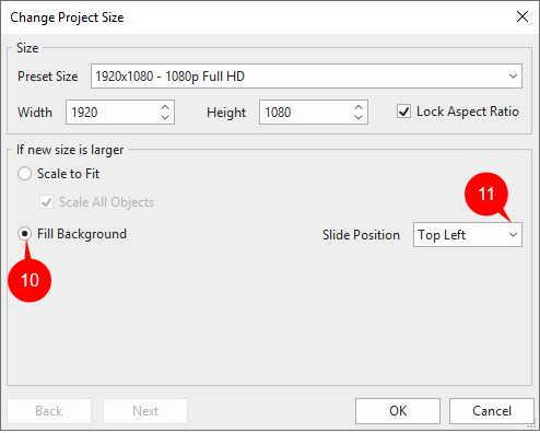

Fill Contents
As being said earlier, when the new size you select is smaller than the old size, you can choose to crop the content. Now, when the new size is larger than the old one, you can choose to fill it if you want.
With this option, ActivePresenter will keep the slide background and fill it with the new size at a specific position. Remember that this option doesn’t resize the slide objects and fill them.
Take the following steps to do that:
Step 1: Click Fill Background (10).
Step 2: Select the slide position to fill from the Slide Position list (11). It’s the position where the filled content appears on the slide.
Step 3: Click OK to apply the fill and close the dialog.

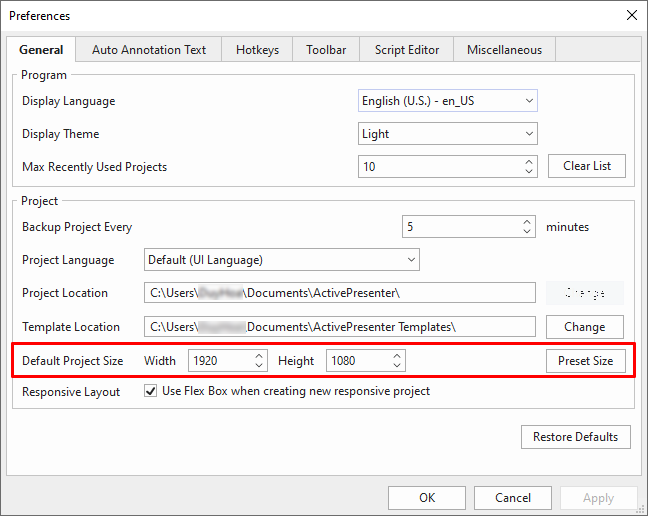

Change Default Project Size
If you want to set the default project size when starting any new project, just access the ActivePresenter button > Preferences > General tab > Default Project Size.
