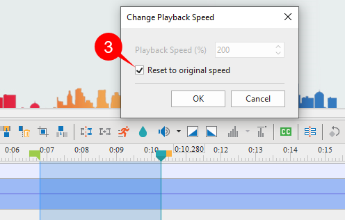

Reset to Original Video Speed
After making changes, you still can restore the original speed. To get it done, do as follows:
Step 1: Select the entire video or select exactly the range that you have changed the speed before.
Tip: Before selecting the range, turn the Timeline Snapping mode on so that you can select it more exactly. To do that, access the View tab and click Timeline Snapping .
Step 2: Click the Change Playback Speed button (1).
Step 3: Select Reset to original speed check box (3). Finally, click OK.
