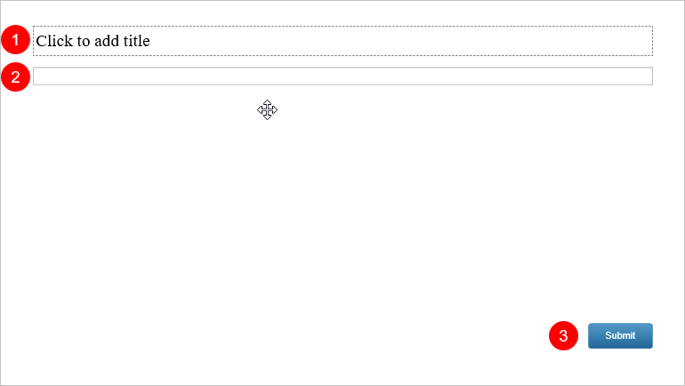

As you can see, a Fill in Text Entry question slide has three parts:
- (1) the top text box to add a question or a statement providing missing information;
- (2) the answer area with only one text entry (or the blank) where learners can type their answer in.
- (3) and the Submit button.

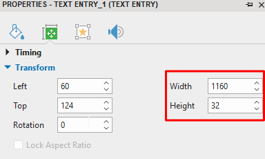

- Resize the question title (1) and answer area (2): You can resize these sections by selecting them and dragging the resizing handles. Or, select them, then go to the Properties pane > Size & Properties tab > Transform to adjust or type the value in the Width and Height combo box:

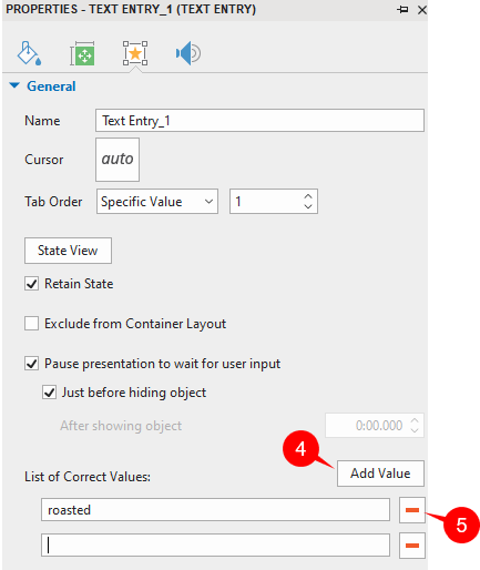

Bear in mind that you cannot directly edit or add text to the text entry. To set correct answers for this question, please follow these steps:
Step 1: Select the text entry, then open the Properties pane > Interactivity tab > General.
Step 2: Click the Add Value button (4) to display a blank box, then type text in the blank box.
If there is more than one correct answer, perform Step 2 again and again.
By following the above steps, you’ve set correct values (correct answers) to the question.
To delete any correct values, simply click the Remove button (5).

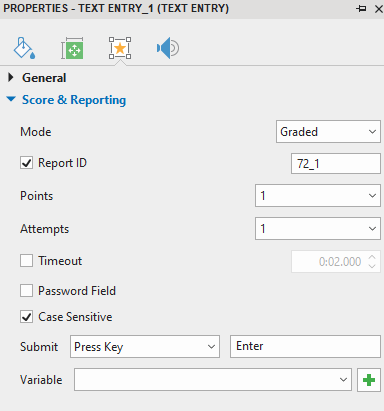

To set score and reporting for the question, select the answer area. Then, go to the Properties pane > Interactivity tab > Score & Reporting.
- Mode: Select the Graded mode if you want to measure learners’ performance, or select the Survey mode if you want to collect learners’ feedback or information;
- Report ID: Track learners’ activities;
- Points: Set points for correct answers;
- Attempts: Set the maximum attempts that learners can interact with the question;
- Timeout: Set a time limit which only allows learners to respond to the question in the given period of time;
- Password Field: Select this check box, all characters that learners type in the text entry will not be shown;
- Case Sensitive: Select this check box to make the uppercase and lowercase characters to be treated differently;
- Submit: Provide users with two options: Press Key or Auto to submit the entered text;
- Variable: Define the variable to take place. See A Complete Overview of Variables for more details.

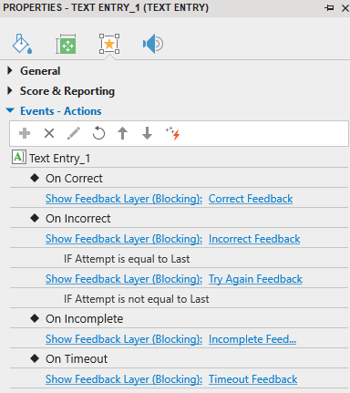

ActivePresenter offers default events and actions for Fill in Text Entry questions. Generally, this question type has four default events for the Graded mode (On Correct, On Incorrect, On Incomplete, and On Timeout) and three for the Survey mode (On Complete, On Incomplete, and On Timeout).
You can remove, change, or make events and actions more advanced as you wish. To do that, first, select the answer area. Then, access the Properties pane > Interactivity tab > Events – Actions.
