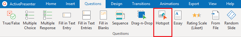

To insert a Hotspot question into your project as a new question slide, perform one of the following:
- In the Questions tab > Hotspot
- In the Home tab > Interactions > Hotspot

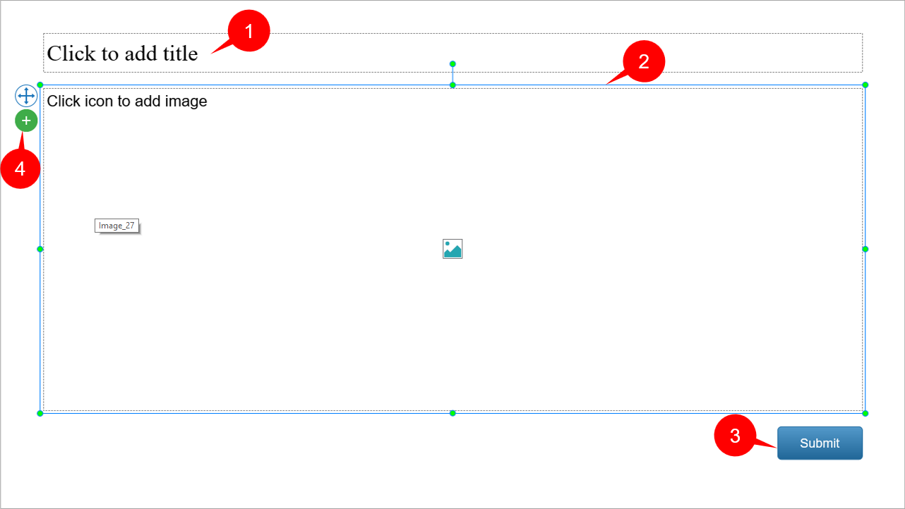

As you can see, a Hotspot question slide has 3 parts:
- (1) The top text box to add the question title;
- (2) The answer area allows inserting an image and adding hotspot areas;
- (3) The Submit button helps learners submit their answers.

- Insert hotspots: Select the answer area, then click the plus button (4) or right-click the image > Add Hotspot Area. After that, select either Oval or Rectangle and apply it to a specific spot you want. You can add many hotspots for one image.

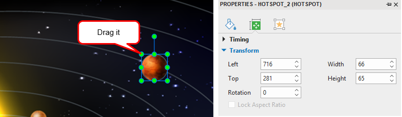

- Resize hotspots: Select a hotspot and drag the anchor points. Otherwise, open the Properties pane > Size & Properties > Transform >adjust or type values in the Width and Height boxes.

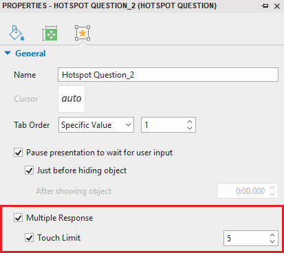

Note: In the Properties pane of the question > Interactivity > General > the Multiple Response check box is selected by default. So, this means learners can give many answers by clicking many spots on an image. Each click they made is considered as an answer. In case you want the last click to be accepted as your answer, deselect this check box. Besides, if you want to limit the number of hotspot touches, you can select the Touch Limit check box and enter its value.

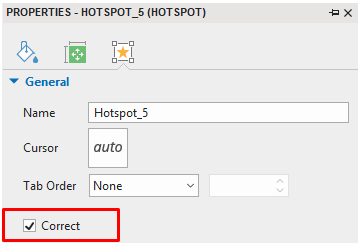

By default, a hotspot that you insert into the image is set as a correct answer. Nevertheless, you can change it into an incorrect answer. To get it done, go to the Properties pane > Interactivity > General > deselect the Correct check box.

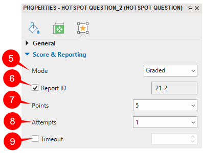

Firstly, to set scores and reporting for a Hotspot question, select the answer area. After that, go to the Properties pane > Interactivity > Score & Reporting.
As can be seen, this section provides you a lot of useful options to:
- (5) measure learners performance (select the Graded mode) or collect learners feedback or information (select the Survey mode);
- (6) track learners results;
- (7) set points for correct answers;
- (8) set the maximum attempts that learners can interact with the question;
- (9) set a time limit that only allows learners to respond to the question in the given period of time.

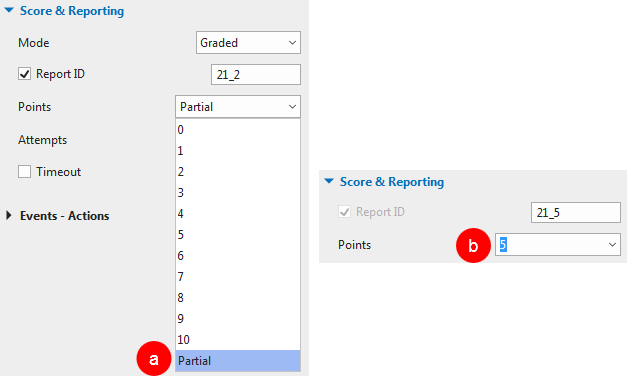

Besides setting scores for the entire hotspot question, it is possible to set scores for each spot. To get it done, select Partial scoring for question (a). Then, go to the Properties pane of each spot > Interactivity > Score & Reporting > Points and specify the point that you want (b).
Note: In case a hotspot question has many correct answers and Multiple Response is allowed, if learners make even one wrong click, they will get the zero score. Otherwise, if learners click correctly, (even the number of correct answers is not enough) they will achieve the total score from the correct spots.

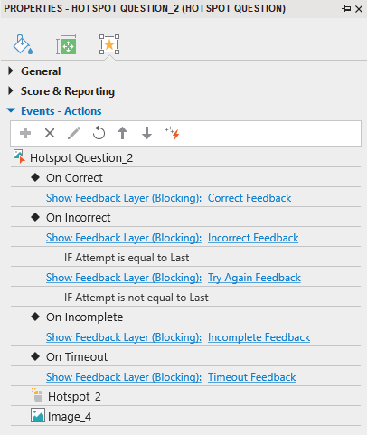

Basically, a Hotspot question has default events and actions. Particularly, in the Graded mode, a Hotspot question has four events: On Correct, On Incorrect, On Incomplete, and On Time Out. However, in the Survey mode, it just has three events: On Complete, On Incomplete, On Timeout. Here is what you’ll see when you’ve selected the Graded mode:
Despite default events and actions, ActivePresenter allows you to change them, delete them or even make them more advanced as you wish. To do that, click on the answer area. Then, go to the Properties pane > Interactivity > Events – Actions.
Refer to Work with Events – Actions for details.
