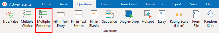

To insert a Multiple Response question, do either of the following:
- In the Questions tab > Multiple Response
- In the Home tab > Interactions > Multiple Response

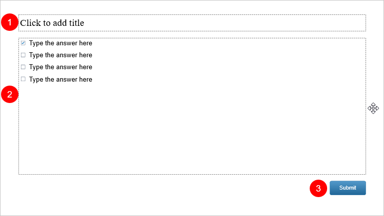

As you can see, a Multiple Response question slide has three parts:
- (1) the top text box to add the question title;
- (2) the answer area with four default answer options;
- (3) and the Submit button.

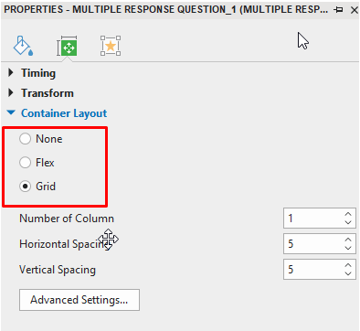

- Change the container layout: Access the Properties pane > Size & Properties tab > Container Layout to change the question layout. In this section, ActivePresenter 8 offers you three options: None, Flex, or Grid. Select the layout mode that you want. Then, you can customize its properties.
See Container Layouts of Questions for more details.

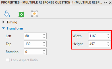

- Resize the question title (1) and the answer area (2): You can resize these sections by selecting them and dragging the resizing handles. Or, select them, then go to the Properties pane > Size & Properties tab > Transform to adjust or type the value in the Width and Height combo box:

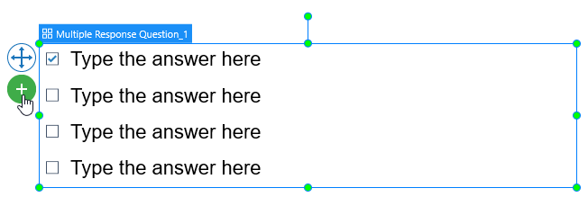

- Insert more answer options: Simply select the answer area (2) and click the plus button:

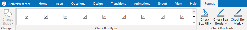

- Edit check boxes: Each answer option comes with a check box. Freely format the check boxes by selecting the answer area then accessing the Format tab. Here, you can select the check box style that you like or customize it as you wish.
See Work with Check Boxes and Radio Buttons for further information.

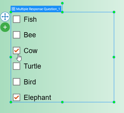

Set Correct Answers for Multiple Response Questions
Double-click the check boxes that correspond to the correct answer options to denote that they are the correct answers to the question:

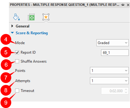

To set score and reporting for a Multiple Response question, select the answer area of the question. Then, go to the Properties pane > Interactivity tab > Score & Reporting.
This section provides a lot of useful options to:
- (4) measure learners performance (select the Graded mode) or collect learners feedback or information (select the Survey mode);
- (5) track learners results;
- (6) mix up answer options when the question is presented to learners;
- (7) set points for correct answers;
- (8) set the maximum attempts that learners can interact with the question;
- (9) set a time limit which only allows learners to respond to the question in the given period of time.

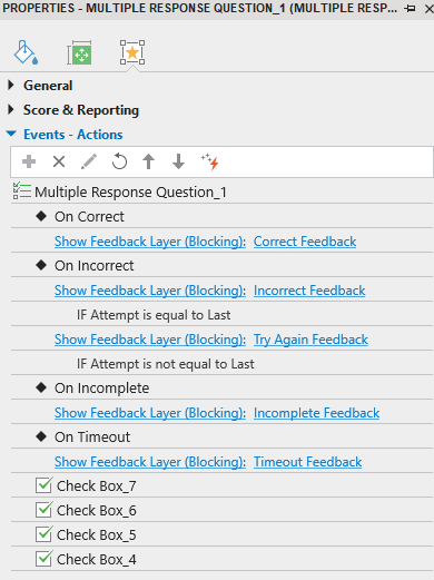

ActivePresenter offers default events and actions for Multiple Response questions. Generally, a Multiple Response question has four default events for the Graded mode (On Correct, On Incorrect, On Incomplete, and On Timeout) and three for the Survey mode (On Complete, On Incomplete, and On Timeout).
You can remove, change, or make events and actions for Multiple Response questions more advanced as you wish. To do that, first, select the answer area. Then, access the Properties pane > Interactivity tab > Events – Actions.
