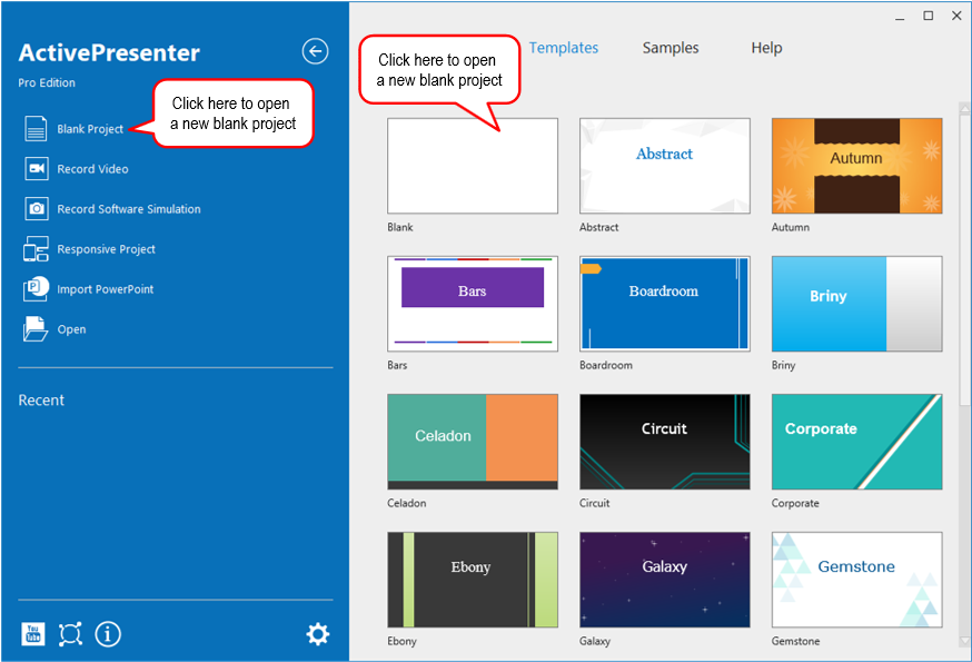

When you first launch the app, you will be presented with the Start Page. To start your first project, click Blank Project in the left pane or click Blank in the built-in templates.

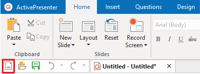

- Click the Create blank project button on the Quick Access Toolbar:

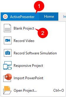

- Click the ActivePresenter button (1) and then click Blank Project (2).
After that, ActivePresenter will launch a new project with a blank slide.

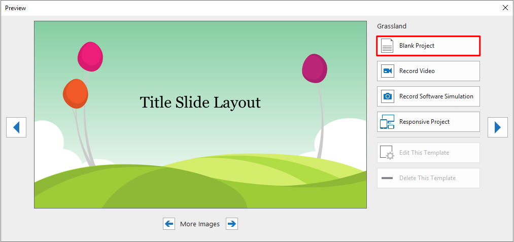

If you want to create a new blank project with any theme, in the Templates tab of the Start Page, do one of the following:
- Right-click any of the themes and select Blank Project from the context menu.
- Click any of the themes and select Blank Project from the pop-up dialog.

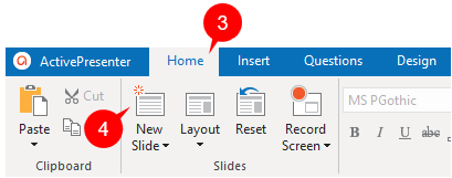

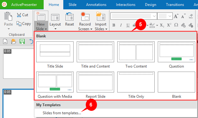

Insert More Slides into Projects
You can add more slides to your project by opening the Home tab (3) or Insert tab, then clicking New Slide (4).
After that, a new slide will be inserted after the slide that you are selecting, having the default layout.

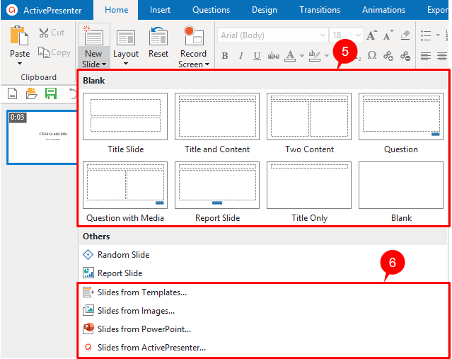

If you want to insert a new slide with a different layout, do the following:
Step 1: Click the drop-down arrow of the New Slide button (4).
Step 2: Select the layout from the drop-down list (5).
Insert Slides from Other Resources
Apart from inserting built-in blank slides with different layouts (5), you are also able to use external slides by importing them (6) from Templates, Images, PowerPoint, and even slides from other ActivePresenter projects.

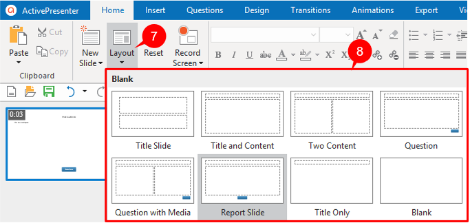

Change Slide Layout
To change the slide layout, take the following steps:
Step 1: Select the slides that you want to change the layout. Hold down CTRL while clicking to select multiple slides.
Step 2: Open the Home tab.
Step 3: Click the Layout button (7).
Step 4: Select the layout that you want to have (8).

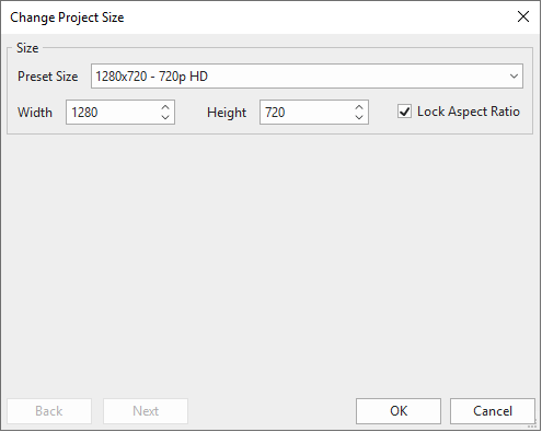

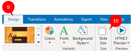

Change Slide Size
After creating a blank project with a default size, you can change the size if needed.
Step 1: Open the Design tab (9).
Step 2: Click Slide Size (10).
After that, the Change Project Size dialog will pop up, do one of the following:
- Select one of the preset sizes from the Preset Size drop-down list.
- Enter values in the Width and Height spin box.
- Check the Lock Aspect Ratio check box if you want to keep the ratio between the width and the height of the slide size.
For more information, refer to How to Change Project Size tutorial.
