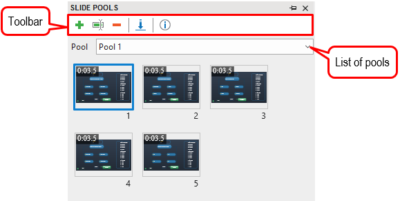

By default, the app gives you “Pool 1” without slides. To add a new pool, do the following:
Step 1: In the View tab > Slide Pools . Then, the Slide Pools pane appears.
Step 2: Click Add to open the Add Pool dialog. Name your pool and click OK.

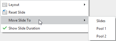

To add slides to a pool, in the Slides pane, right-click one or more slides > Move Slide To > select a pool. As these slides are moved to the Slide Pools pane, they no longer appear in the Slides pane.
Tip: You can also cut and paste slides from the Slides pane to the Slide Pools pane.

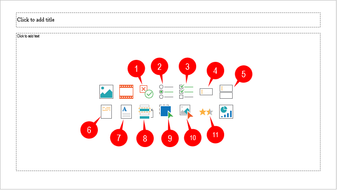

To do this, in a pool, right-click anywhere in the Slide Pools pane > New Slide. In case you right-click a slide early on, the new slide will have the same theme and layout properties as the selected slide. Otherwise, the new slide inherits theme properties from the first theme of the current project. In the latter case, the new slide will appear with the layout like this:
You can also create question slides right inside the pool. ActivePresenter 8 currently supports you to create 11 types of interactive questions with a few clicks.
(1) True/False (2) Multiple Choice (3) Multiple Response (4) Fill in Text Entry | (5) Fill in Text Entries (6) Fill in Blanks (7) Essay (8) Sequence | (9) Drag-n-Drop (10) Hotspot (11) Rating Scale (Likert) |

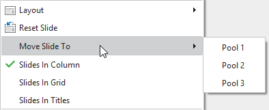

Step 2: Right-click one or more slides in that pool > Move Slide To > select another pool or the Slides pane in the current project to which you want to move that slide.
Note: Apart from this, you can also copy slides in a pool and paste them into another pool or into the Slides pane.

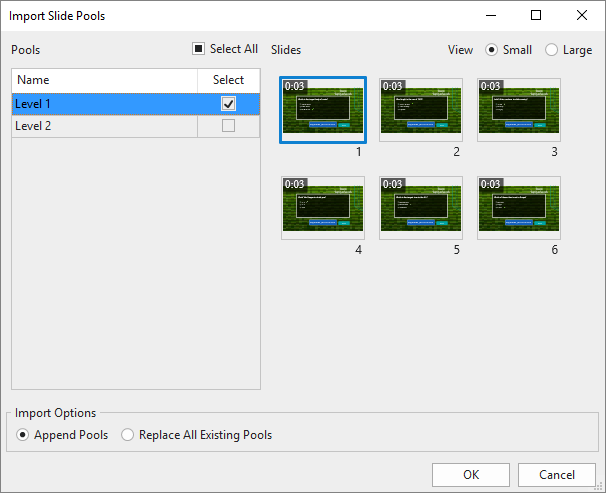

Step 1: In the Slide Pools pane > Import Pool .
Step 2: Browse your file system and select a project file (*.approj) which contains slide pools you want to reuse. Then, the Import Slide Pools window appears like this.
This window has two boxes:
- The Pools box is where to show pools in the selected project.
- The Slides box displays all slides in each pool. To change the view mode, click the Small or Large button.
Step 3: Select a pool to import. By default, all pools are selected. But if you don’t want to import any pool, just deselect the corresponding check box.
Step 4: Select import options.
- Append Pools: Import a pool as a new pool and keep all previously created pools in the current project.
- Replace All Existing Pools: Import a pool as a new pool and replace all previously created pools in the current project.
Step 5: Click OK to apply changes.
