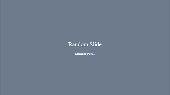

Then, you see the random slide like this.
As being seen, the random slide has a gray background and is labeled as “Random Slide”. By default, the random slide is linked to “Pool 1” which is the first pool in the Slide Pools pane, but you can change it later.

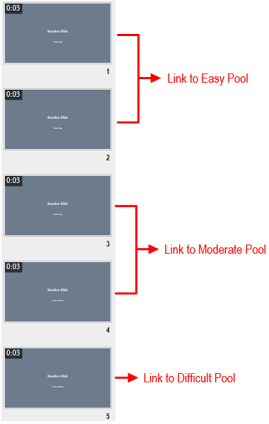

When randomizing questions, it’s better to ensure each learner gets a quiz that is equally difficult. To do this, set the difficulty level for each question. Then, sort questions based on their degree of difficulty into separate pools. This way, you can have individual pools for each difficulty level with a certain number of questions, such as one pool for 10 easy questions, one pool for 10 moderate questions, and one pool for 10 difficult questions.
To be more precise, for example, if you want to create a quiz with 5 random questions including 2 easy ones, 2 moderate ones, and 1 difficult one.
You simply need to insert 5 random slides. Then, link 2 random slides to the easy pool, 2 random slides to the moderate pool, and 1 other one to the difficult pool.
As a result, your quiz will display 2 easy questions, 2 moderate questions, and 1 difficult question which are randomly selected from the 10 questions in each corresponding linked pool.
