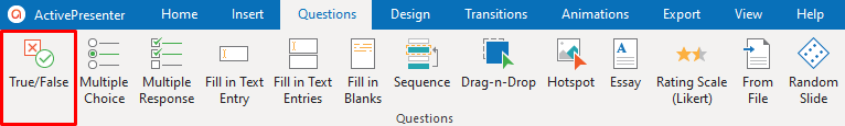

In ActivePresenter 8, True/False is the first question type that you can see in the Questions tab:

To insert a True/False question, do either of the following:
- In the Questions tab > True/False
- In the Home tab > Interactions > True/False

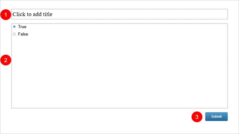

As you can see, a True/False question slide has three parts:
- (1) the top text box to the add question title;
- (2) the answer area with two default answer options: True – False;
- (3) and the Submit button.

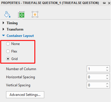

- Change the container layout: To change the question layout, access the Properties pane > Size & Properties tab > Container Layout. In this section, ActivePresenter 8 offers you three options: None, Flex, or Grid. Select the layout mode that you want. Then, you can customize its properties.
See Container Layouts of Questions for more details.

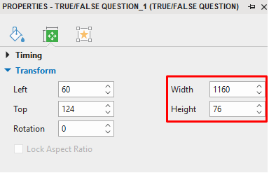

- Resize the question title (1) and the answer area (2): You can resize these sections by selecting them and dragging the resizing handles. Or, select them, then go to the Properties pane > Size & Properties tab > Transform to adjust or type the value in the Width and Height combo box:

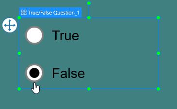

Set Correct Answer for True/False Questions
Double-click the radio button that corresponds to the correct answer option to denote that it is the correct answer:

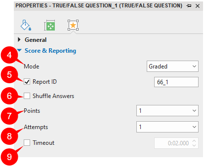

To set score and reporting for a True/False question, select the answer area of the question. Then, go to the Properties pane > Interactivity tab > Score & Reporting.
This section provides a lot of useful options to:
- (4) measure learners performance (select the Graded mode) or collect learners feedback or information (select the Survey mode);
- (5) track learners results;
- (6) mix up answer options when the question is presented to learners;
- (7) set points for correct answers;
- (8) set the maximum attempts that learners can interact with the question;
- (9) set a time limit which only allows learners to respond to the question in the given period of time.

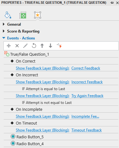

ActivePresenter offers default events and actions for True/False questions. Generally, a True/False question has four default events for the Graded mode (On Correct, On Incorrect, On Incomplete, and On Timeout) and three for the Survey mode (On Complete, On Incomplete, and On Timeout).
You can remove, change, or make events and actions for True/False questions more advanced as you wish. To do that, first, select the answer area. Then, access the Properties pane > Interactivity tab > Events – Actions.
